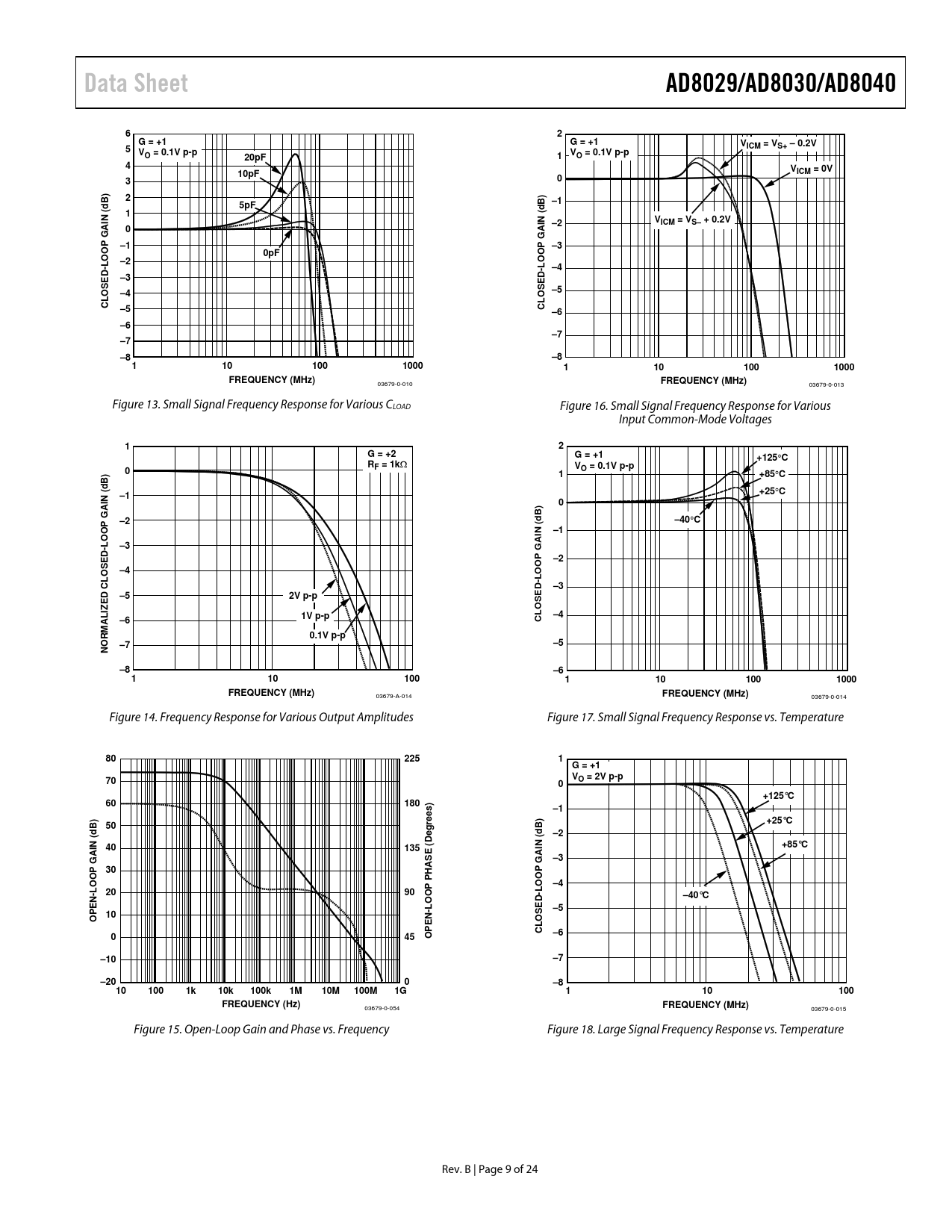

Pages / Page24 / 9 — Data Sheet. AD8029/AD8030/AD8040. G = +1. ICM = VS+ – 0.2V. VO = 0.1V …
RevisionB
File Format / SizePDF / 454 Kb
Data Sheet. AD8029/AD8030/AD8040. G = +1. ICM = VS+ – 0.2V. VO = 0.1V p-p. 20pF. O = 0.1V p-p. 10pF. ICM = 0V. 5pF. VICM = VS– + 0.2V. 0pF
Data Sheet AD8029/AD8030/AD8040 G = +1 ICM = VS+ – 0.2V VO = 0.1V p-p 20pF O = 0.1V p-p 10pF ICM = 0V 5pF VICM = VS– + 0.2V 0pF
Data Sheet AD8029/AD8030/AD8040 6 2 G = +1 G = +1 V 5 ICM = VS+ – 0.2V VO = 0.1V p-p V 20pF 1 O = 0.1V p-p 4 V 10pF ICM = 0V 3 0 2 –1 5pF 1 –2 VICM = VS– + 0.2V 0 –1 –3 0pF –2 –4 –3 –4 –5 CLOSED-LOOP GAIN (dB) –5 CLOSED-LOOP GAIN (dB) –6 –6 –7 –7 –8 –8 1 10 100 1000 1 10 100 1000 FREQUENCY (MHz)
03679-0-010
FREQUENCY (MHz)
03679-0-013 Figure 13. Small Signal Frequency Response for Various CLOAD Figure 16. Small Signal Frequency Response for Various Input Common-Mode Voltages
1 2 G = +2 G = +1 +125
C R V 0 F = 1k
O = 0.1V p-p 1 +85
C +25
C –1 0 ) –2 dB ( –40
C –1 IN –3 GA –2 –4 -LOOP D –3 –5 2V p-p E 1V p-p LOS –4 –6 C 0.1V p-p –7 –5 NORMALIZED CLOSED-LOOP GAIN (dB) –8 –6 1 10 100 1 10 100 1000 FREQUENCY (MHz)
03679-A-014
FREQUENCY (MHz)
03679-0-014 Figure 14. Frequency Response for Various Output Amplitudes Figure 17. Small Signal Frequency Response vs. Temperature
80 225 1 G = +1 V 70 O = 2V p-p 0 +125°C 60 180 –1 +25°C 50 –2 40 135 +85°C –3 30 –4 20 90 –40°C –5 10 OPEN-LOOP GAIN (dB) CLOSED-LOOP GAIN (dB) 0 –6 45 OPEN-LOOP PHASE (Degrees) –10 –7 –20 0 –8 10 100 1k 10k 100k 1M 10M 100M 1G 1 10 100 FREQUENCY (Hz) FREQUENCY (MHz)
03679-0-054 03679-0-015 Figure 15. Open-Loop Gain and Phase vs. Frequency Figure 18. Large Signal Frequency Response vs. Temperature Rev. B | Page 9 of 24 Document Outline Features Applications Connection Diagrams General Description Table of Contents Revision History Specifications Specifications with ±5 V Supply Specifications with +5 V Supply Specifications with +3 V Supply Absolute Maximum Ratings Maximum Power Dissipation Output Short Circuit ESD Caution Typical Performance Characteristics Theory of Operation Input Stage Output Stage Applications Wideband Operation Output Loading Sensitivity Disable Pin Circuit Considerations PCB Layout Grounding Power Supply Bypassing Design Tools and Technical Support Outline Dimensions Ordering Guide
