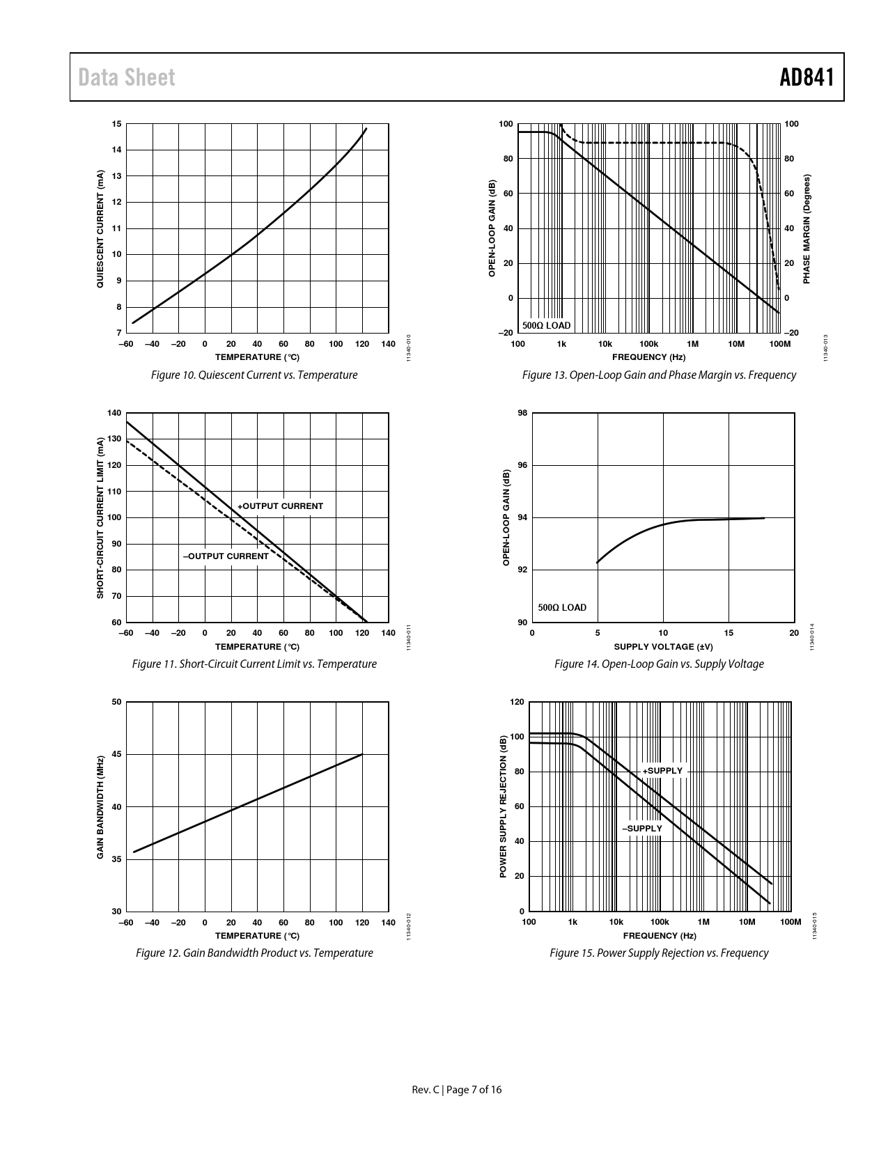

Data Sheet. AD841. 100. mA). rees). Deg. IN (. CURRE. ARG. -LOOP. E UI. HAS. 500Ω LOAD. –20. –60. –40. 120. 140. 10k. 100k. 10M. 100M. TEMPERATURE (°C)
Data Sheet AD841 100 mA) rees) Deg IN ( CURRE ARG -LOOP E UI HAS 500Ω LOAD –20 –60 –40 120 140 10k 100k 10M 100M TEMPERATURE (°C)
Data Sheet AD841 15 100 100 14 80 80 13 mA) ) ( dB 60 60 rees) NT ( 12 IN Deg GA IN ( 11 40 40 CURRE ARG NT -LOOP 10 M CE N E S E 20 20 E UI OP HAS 9 Q P 0 0 8 500Ω LOAD 7 –20 –20 –60 –40 –20 0 20 40 60 80 100 120 140
010
100 1k 10k 100k 1M 10M 100M
013
TEMPERATURE (°C)
1340- 1340- 1
FREQUENCY (Hz)
1 Figure 10. Quiescent Current vs. Temperature Figure 13. Open-Loop Gain and Phase Margin vs. Frequency
140 98 130 mA) ( IT 120 96 ) IM L dB ( 110 NT IN +OUTPUT CURRENT GA 100 94 CURRE T -LOOP 90 N RCUI E –OUTPUT CURRENT -CI OP 80 92 RT HO S 70 500Ω LOAD 60 90
1 1
0
0 5 10 15 20
014
TEMPERATURE (°C)
1340- 1340- 1
SUPPLY VOLTAGE (±V)
1 Figure 11. Short-Circuit Current Limit vs. Temperature Figure 14. Open-Loop Gain vs. Supply Voltage
50 120 ) 100 B ) 45 (d N Hz IO M 80 T +SUPPLY H ( EC IDT EJ 40 60 Y R PPL –SUPPLY N BANDW SU 40 AI G ER 35 W PO 20 30 0 –60 –40 –20 0 20 40 60 80 100 120 140
012
015
TEMPERATURE (°C)
1340-
FREQUENCY (Hz)
1340- 1 1 Figure 12. Gain Bandwidth Product vs. Temperature Figure 15. Power Supply Rejection vs. Frequency Rev. C | Page 7 of 16 Document Outline Features Applications Connection Diagrams General Description Product Highlights Revision History Specifications Absolute Maximum Ratings Thermal Characteristics ESD Caution Typical Performance Characteristics Theory of Operation Offset Nulling Input Considerations AD841 Settling Time Grounding and Bypassing Capacitive Load Driving Ability Terminated Line Driver Overdrive Recovery Outline Dimensions Ordering Guide
