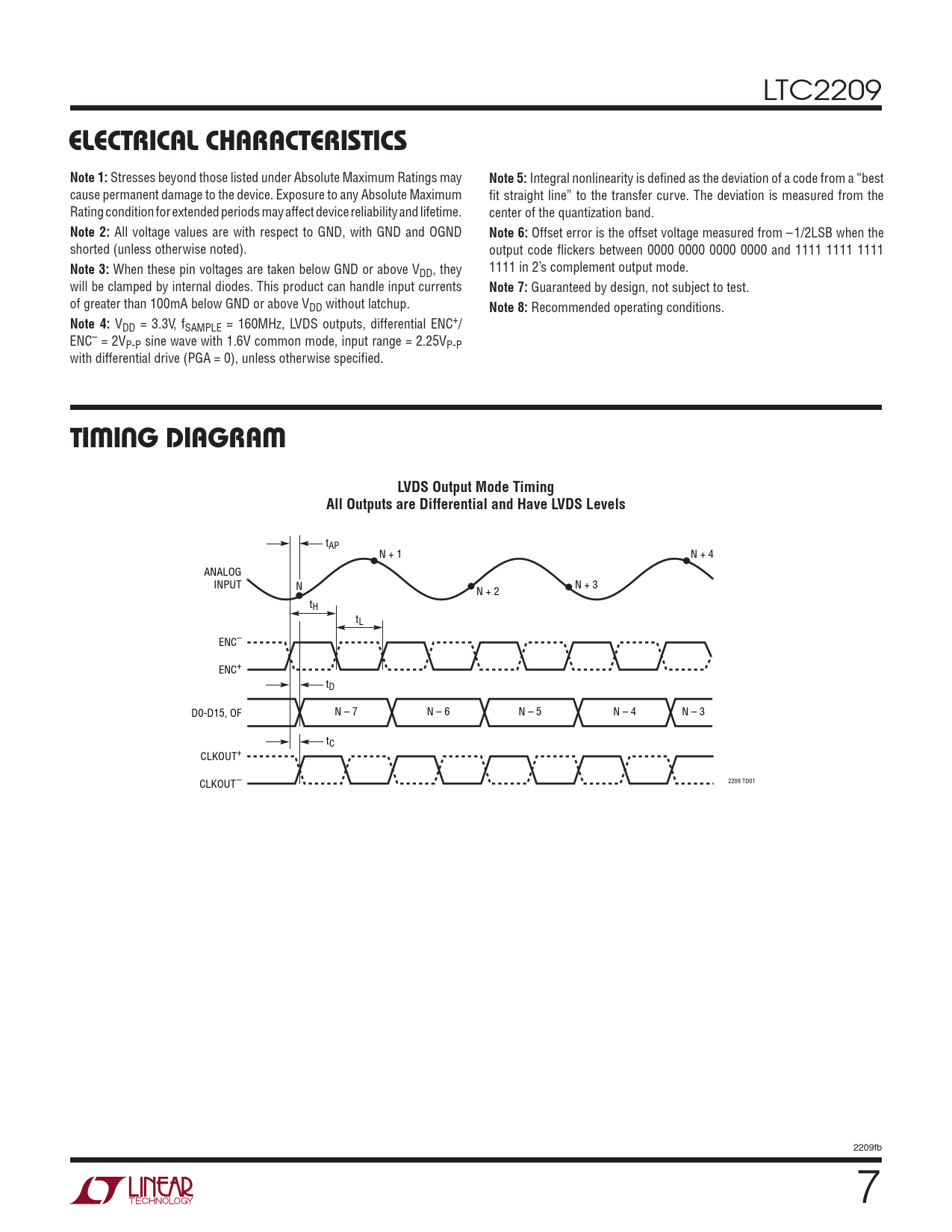

electrical characteristics. Note 1:. Note 5:. Note 2:. Note 6:. Note 3:. Note 7:. Note 8:. Note 4:. tiMing DiagraM. LVDS Output Mode Timing
electrical characteristics Note 1: Note 5: Note 2: Note 6: Note 3: Note 7: Note 8: Note 4: tiMing DiagraM LVDS Output Mode Timing
LTC2209
Stresses beyond those listed under Absolute Maximum Ratings may
Note 5:
Integral nonlinearity is defined as the deviation of a code from a “best cause permanent damage to the device. Exposure to any Absolute Maximum fit straight line” to the transfer curve. The deviation is measured from the Rating condition for extended periods may affect device reliability and lifetime. center of the quantization band.
Note 2:
All voltage values are with respect to GND, with GND and OGND
Note 6:
Offset error is the offset voltage measured from –1/2LSB when the shorted (unless otherwise noted). output code flickers between 0000 0000 0000 0000 and 1111 1111 1111
Note 3:
When these pin voltages are taken below GND or above VDD, they 1111 in 2’s complement output mode. will be clamped by internal diodes. This product can handle input currents
Note 7:
Guaranteed by design, not subject to test. of greater than 100mA below GND or above VDD without latchup.
Note 8:
Recommended operating conditions.
Note 4:
VDD = 3.3V, fSAMPLE = 160MHz, LVDS outputs, differential ENC+/ ENC– = 2VP-P sine wave with 1.6V common mode, input range = 2.25VP-P with differential drive (PGA = 0), unless otherwise specified.
tiMing DiagraM LVDS Output Mode Timing All Outputs are Differential and Have LVDS Levels
tAP N + 1 N + 4 ANALOG INPUT N N + 3 N + 2 tH tL ENC– ENC+ tD D0-D15, OF N – 7 N – 6 N – 5 N – 4 N – 3 tC CLKOUT+ CLKOUT– 2209 TD01 2209fb 7 Document Outline Features Applications Description Typical Application Absolute Maximum Ratings Pin Configuration Order Information Converter Characteristics Analog Input Dynamic Accuracy Common Mode Bias Characteristics Digital Inputs and Digital Outputs Power Requirements Timing Characteristics Electrical Characteristics Timing Diagram Typical Performance Characteristics Pin Functions Block Diagram Definitions Applications Information Package Description Revision History Related Parts
