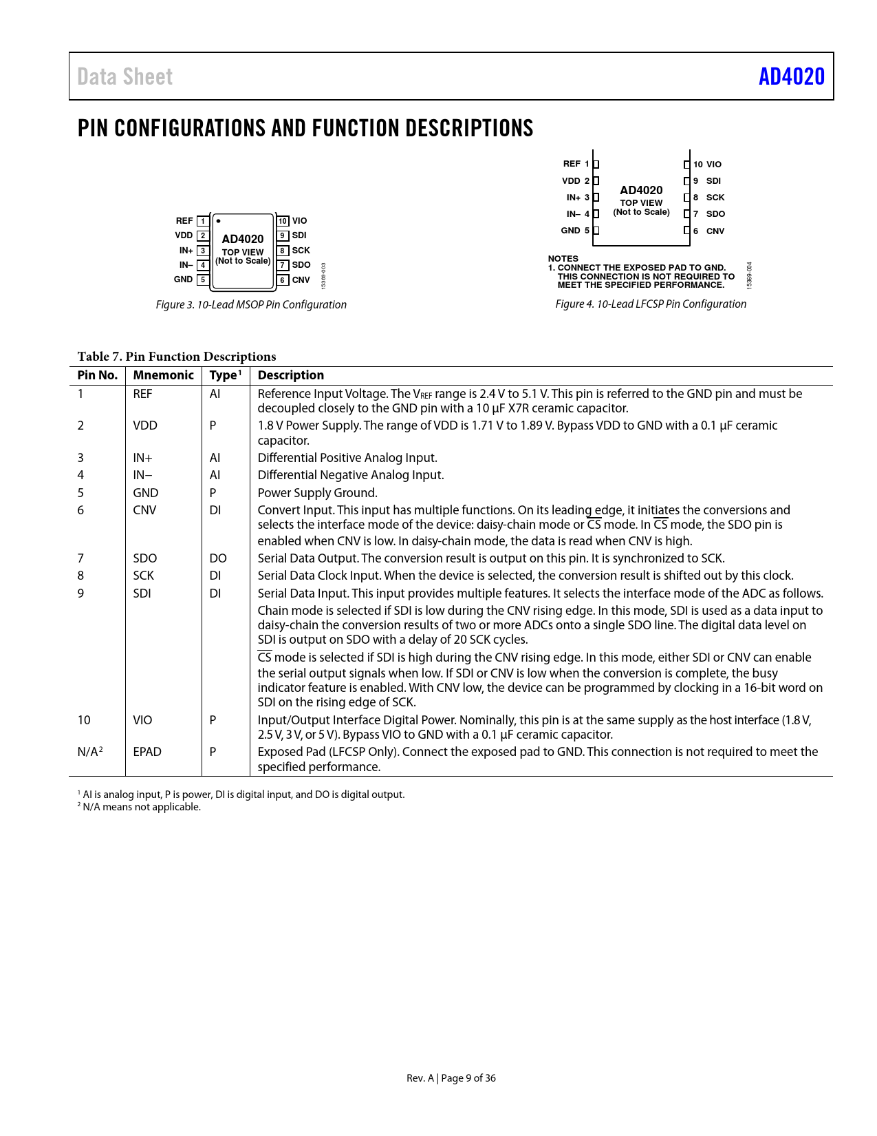

Data Sheet. AD4020. PIN CONFIGURATIONS AND FUNCTION DESCRIPTIONS. REF 1. 10 VIO. VDD 2. SDI. IN+ 3. SCK. TOP VIEW. IN– 4. (Not to Scale). SDO
Data Sheet AD4020 PIN CONFIGURATIONS AND FUNCTION DESCRIPTIONS REF 1 10 VIO VDD 2 SDI IN+ 3 SCK TOP VIEW IN– 4 (Not to Scale) SDO
Data Sheet AD4020 PIN CONFIGURATIONS AND FUNCTION DESCRIPTIONS REF 1 10 VIO VDD 2 9 SDI AD4020 IN+ 3 8 SCK TOP VIEW IN– 4 (Not to Scale) 7 SDO REF 1 10 VIO GND 5 6 CNV VDD 2 9 SDI AD4020 IN+ 3 8 SCK TOP VIEW NOTES IN– (Not to Scale) 4 7 SDO 1. CONNECT THE EXPOSED PAD TO GND.
003 004
GND THIS CONNECTION IS NOT REQUIRED TO 5 6 CNV MEET THE SPECIFIED PERFORMANCE.
15369- 15369- Figure 3. 10-Lead MSOP Pin Configuration Figure 4. 10-Lead LFCSP Pin Configuration
Table 7. Pin Function Descriptions Pin No. Mnemonic Type1 Description
1 REF AI Reference Input Voltage. The VREF range is 2.4 V to 5.1 V. This pin is referred to the GND pin and must be decoupled closely to the GND pin with a 10 µF X7R ceramic capacitor. 2 VDD P 1.8 V Power Supply. The range of VDD is 1.71 V to 1.89 V. Bypass VDD to GND with a 0.1 μF ceramic capacitor. 3 IN+ AI Differential Positive Analog Input. 4 IN− AI Differential Negative Analog Input. 5 GND P Power Supply Ground. 6 CNV DI Convert Input. This input has multiple functions. On its leading edge, it initiates the conversions and selects the interface mode of the device: daisy-chain mode or CS mode. In CS mode, the SDO pin is enabled when CNV is low. In daisy-chain mode, the data is read when CNV is high. 7 SDO DO Serial Data Output. The conversion result is output on this pin. It is synchronized to SCK. 8 SCK DI Serial Data Clock Input. When the device is selected, the conversion result is shifted out by this clock. 9 SDI DI Serial Data Input. This input provides multiple features. It selects the interface mode of the ADC as follows. Chain mode is selected if SDI is low during the CNV rising edge. In this mode, SDI is used as a data input to daisy-chain the conversion results of two or more ADCs onto a single SDO line. The digital data level on SDI is output on SDO with a delay of 20 SCK cycles. CS mode is selected if SDI is high during the CNV rising edge. In this mode, either SDI or CNV can enable the serial output signals when low. If SDI or CNV is low when the conversion is complete, the busy indicator feature is enabled. With CNV low, the device can be programmed by clocking in a 16-bit word on SDI on the rising edge of SCK. 10 VIO P Input/Output Interface Digital Power. Nominally, this pin is at the same supply as the host interface (1.8 V, 2.5 V, 3 V, or 5 V). Bypass VIO to GND with a 0.1 μF ceramic capacitor. N/A2 EPAD P Exposed Pad (LFCSP Only). Connect the exposed pad to GND. This connection is not required to meet the specified performance. 1 AI is analog input, P is power, DI is digital input, and DO is digital output. 2 N/A means not applicable. Rev. A | Page 9 of 36 Document Outline FEATURES APPLICATIONS GENERAL DESCRIPTION FUNCTIONAL BLOCK DIAGRAM TABLE OF CONTENTS REVISION HISTORY SPECIFICATIONS TIMING SPECIFICATIONS ABSOLUTE MAXIMUM RATINGS THERMAL RESISTANCE ESD CAUTION PIN CONFIGURATIONS AND FUNCTION DESCRIPTIONS TYPICAL PERFORMANCE CHARACTERISTICS TERMINOLOGY THEORY OF OPERATION CIRCUIT INFORMATION CONVERTER OPERATION TRANSFER FUNCTIONS APPLICATIONS INFORMATION TYPICAL APPLICATION DIAGRAMS ANALOG INPUTS Input Overvoltage Clamp Circuit Differential Input Considerations Switched Capacitor Input RC Filter Values DRIVER AMPLIFIER CHOICE Single to Differential Driver High Frequency Input Signals Multiplexed Applications EASE OF DRIVE FEATURES Input Span Compression High-Z Mode Long Acquisition Phase VOLTAGE REFERENCE INPUT POWER SUPPLY DIGITAL INTERFACE REGISTER READ/WRITE FUNCTIONALITY STATUS WORD /CS MODE, 3-WIRE TURBO MODE /CS MODE, 3-WIRE WITHOUT THE BUSY INDICATOR /CS MODE, 3-WIRE WITH THE BUSY INDICATOR /CS MODE, 4-WIRE TURBO MODE /CS MODE, 4-WIRE WITHOUT THE BUSY INDICATOR /CS MODE, 4-WIRE WITH THE BUSY INDICATOR DAISY-CHAIN MODE LAYOUT GUIDELINES EVALUATING THE AD4020 PERFORMANCE OUTLINE DIMENSIONS ORDERING GUIDE
