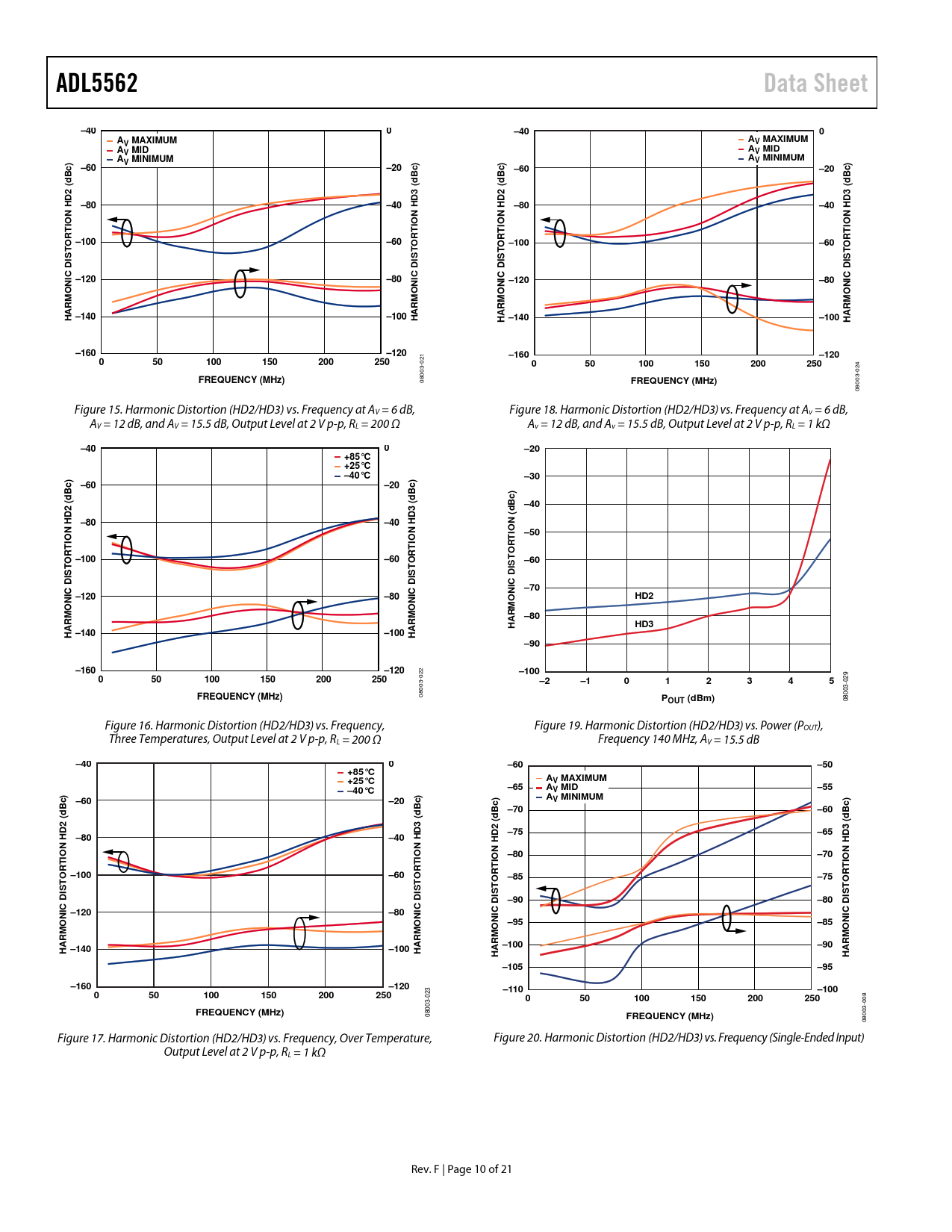

ADL5562. Data Sheet. –40. V MAXIMUM. V MID. V MINIMUM. –60. –20. Bc). –80. N HD2 (. N HD3 (. O –100. C DI. –120. –140. –100. HARM. –160. 100. 150. 200. 250

08003- Figure 15. Harmonic Distortion (HD2/HD3) vs. Frequency at AV = 6 dB, Figure 18. Harmonic Distortion (HD2/HD3) vs. Frequency at Av = 6 dB, AV = 12 dB, and AV = 15.5 dB, Output Level at 2 V p-p, RL = 200 Ω Av = 12 dB, and Av = 15.5 dB, Output Level at 2 V p-p, RL = 1 kΩ

Figure 16. Harmonic Distortion (HD2/HD3) vs. Frequency, Figure 19. Harmonic Distortion (HD2/HD3) vs. Power (POUT), Three Temperatures, Output Level at 2 V p-p, RL = 200 Ω Frequency 140 MHz, AV = 15.5 dB

08003- Figure 17. Harmonic Distortion (HD2/HD3) vs. Frequency, Over Temperature, Figure 20. Harmonic Distortion (HD2/HD3) vs. Frequency (Single-Ended Input) Output Level at 2 V p-p, RL = 1 kΩ Rev. F | Page 10 of 21 Document Outline FEATURES APPLICATIONS FUNCTIONAL BLOCK DIAGRAM GENERAL DESCRIPTION TABLE OF CONTENTS REVISION HISTORY SPECIFICATIONS ABSOLUTE MAXIMUM RATINGS ESD CAUTION PIN CONFIGURATION AND FUNCTION DESCRIPTIONS TYPICAL PERFORMANCE CHARACTERISTICS CIRCUIT DESCRIPTION BASIC STRUCTURE APPLICATIONS INFORMATION BASIC CONNECTIONS INPUT AND OUTPUT INTERFACING Single-Ended Input to Differential Output GAIN ADJUSTMENT AND INTERFACING ADC INTERFACING LAYOUT CONSIDERATIONS SOLDERING INFORMATION EVALUATION BOARD OUTLINE DIMENSIONS ORDERING GUIDE
