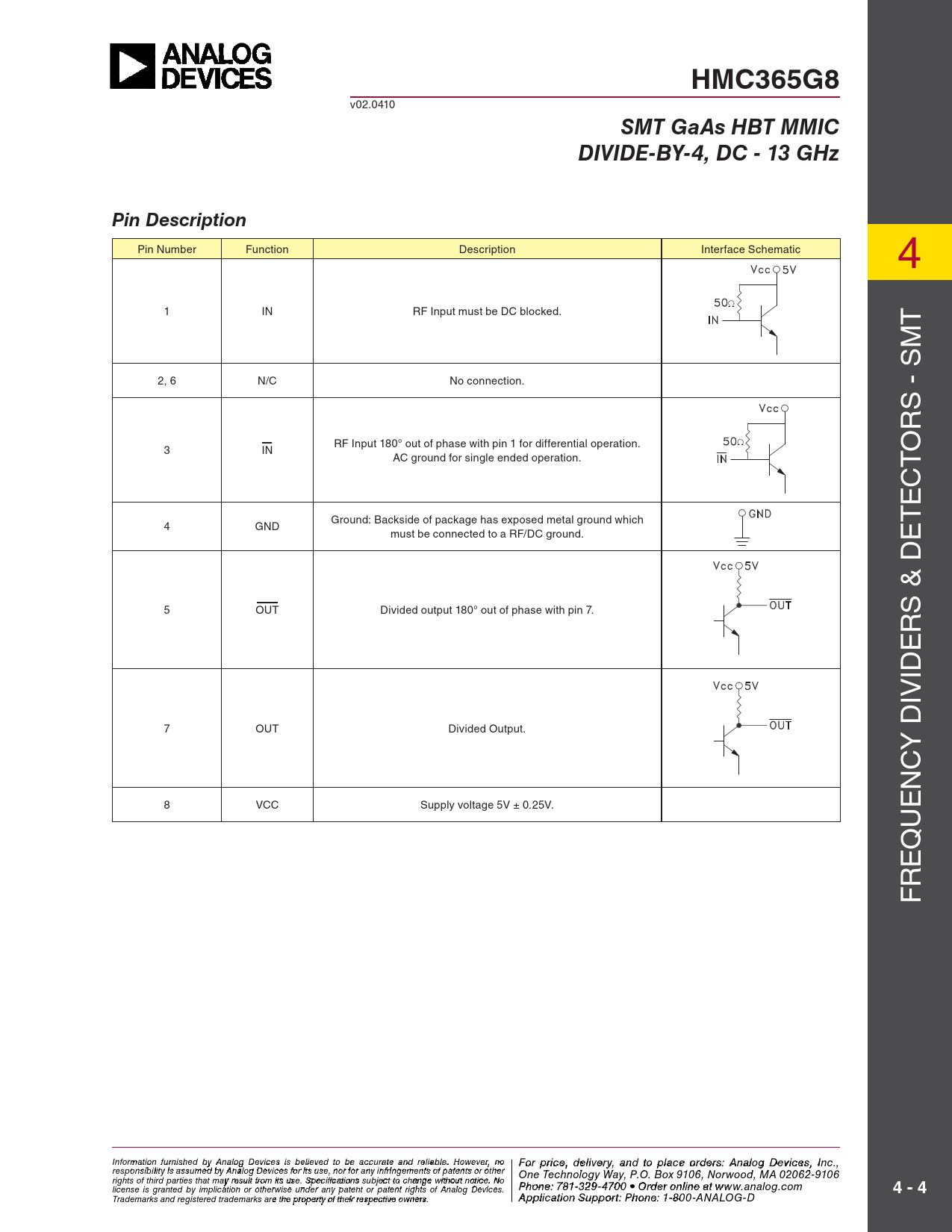

SMT GaAs HBT MMIC DIVIDE-BY-4, DC - 13 GHz Pin Description
Pin Number Function Description Interface Schematic 4 1 IN RF Input must be DC blocked. T 2, 6 N/C No connection. S - SM R RF Input 180° out of phase with pin 1 for differential operation. 3 IN O AC ground for single ended operation. T C E Ground: Backside of package has exposed metal ground which T 4 GND must be connected to a RF/DC ground. E & D 5 OUT Divided output 180° out of phase with pin 7. S R E ID IV 7 OUT Divided Output. Y D NC 8 VCC Supply voltage 5V ± 0.25V. E U Q E R F Info F rmoatr pr ion f iurcne, de ished b ly iv A e n r al y o a g D n evd to p ices is bla eli c eve o ed t rde o be ras: H ccuratite tiatne M d reli iacr ble ow . Ho av wev e C er, n o o rpo Fora r t p iro ic n e ,, 2 d 0 eli A ve lrpha R y, and toad, C o place hoel rd m er s s fo : Ard, MA 01 nalog Devic 8 e 2 s 4 , Inc., responsibility is assumed by Analog Devices for its use, nor for any infringements of patents or other One Technology Way, P.O. Box 9106, Norwood, MA 02062-9106 Phone: 978-250-3343 Fax: 978-250-3373 O rights of third parties that may result from its use. Specifications subject to change without notice. No P rde hone r O : 7 n 81- -3li 2n 9 e a -47 t w 0 w 0 • O w rd .ehit r o t nilte in .c e ao t m license is granted by implication or otherwise under any patent or patent rights of Analog Devices. www.analog.com
