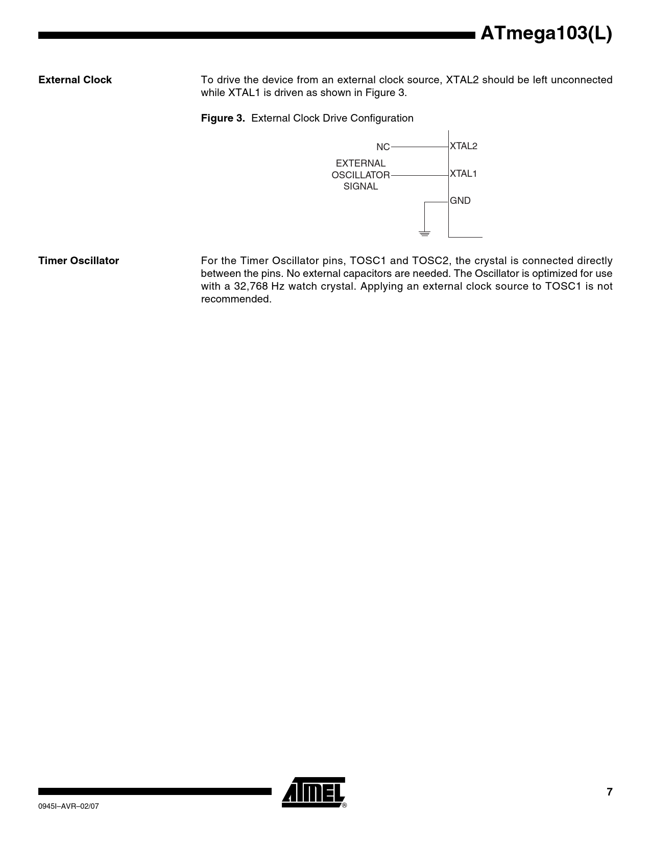

ATmega103(L) External Clock
To drive the device from an external clock source, XTAL2 should be left unconnected while XTAL1 is driven as shown in Figure 3.
Figure 3.
External Clock Drive Configuration NC XTAL2 EXTERNAL OSCILLATOR XTAL1 SIGNAL GND
Timer Oscillator
For the Timer Oscillator pins, TOSC1 and TOSC2, the crystal is connected directly between the pins. No external capacitors are needed. The Oscillator is optimized for use with a 32,768 Hz watch crystal. Applying an external clock source to TOSC1 is not recommended.
