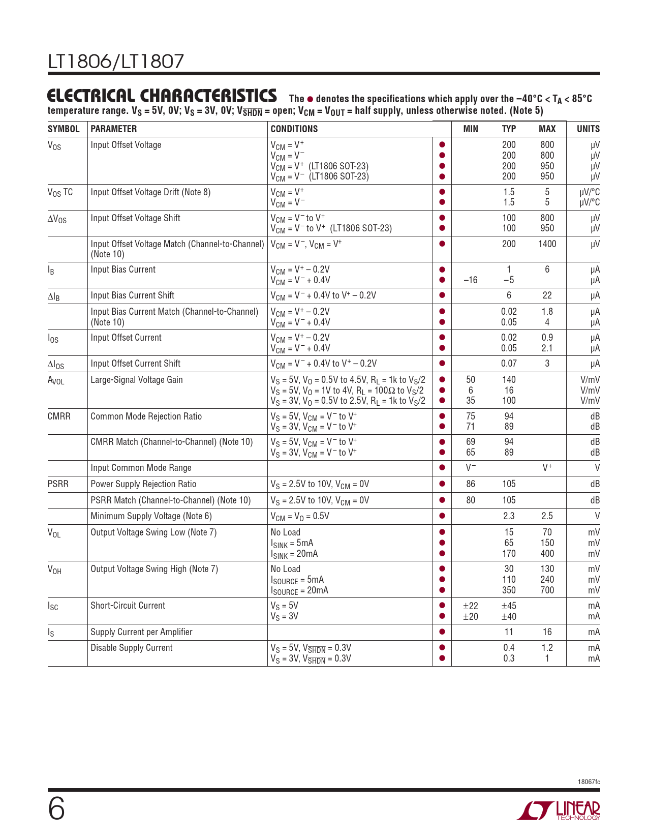

ELECTRICAL CHARACTERISTICS. The. denotes the specifi cations which apply over the –40°C < TA < 85°C
ELECTRICAL CHARACTERISTICS The denotes the specifi cations which apply over the –40°C < TA < 85°C
LT1806/LT1807
l
denotes the specifi cations which apply over the –40°C < TA < 85°C temperature range. VS = 5V, 0V; VS = 3V, 0V; VSHDN = open; VCM = VOUT = half supply, unless otherwise noted. (Note 5) SYMBOL PARAMETER CONDITIONS MIN TYP MAX UNITS
VOS Input Offset Voltage VCM = V+ l 200 800 μV VCM = V – l 200 800 μV VCM = V+ (LT1806 SOT-23) l 200 950 μV VCM = V – (LT1806 SOT-23) l 200 950 μV VOS TC Input Offset Voltage Drift (Note 8) VCM = V+ l 1.5 5 μV/°C VCM = V – l 1.5 5 μV/°C ΔV l OS Input Offset Voltage Shift VCM = V– to V+ 100 800 μV VCM = V– to V+ (LT1806 SOT-23) l 100 950 μV Input Offset Voltage Match (Channel-to-Channel) VCM = V –, VCM = V+ l 200 1400 μV (Note 10) IB Input Bias Current VCM = V+ – 0.2V l 1 6 μA VCM = V – + 0.4V l –16 – 5 μA ΔIB Input Bias Current Shift VCM = V – + 0.4V to V+ – 0.2V l 6 22 μA Input Bias Current Match (Channel-to-Channel) VCM = V+ – 0.2V l 0.02 1.8 μA (Note 10) VCM = V – + 0.4V l 0.05 4 μA IOS Input Offset Current VCM = V+ – 0.2V l 0.02 0.9 μA VCM = V – + 0.4V l 0.05 2.1 μA ΔIOS Input Offset Current Shift VCM = V – + 0.4V to V+ – 0.2V l 0.07 3 μA AVOL Large-Signal Voltage Gain VS = 5V, VO = 0.5V to 4.5V, RL = 1k to VS/2 l 50 140 V/mV VS = 5V, VO = 1V to 4V, RL = 100Ω to VS/2 l 6 16 V/mV VS = 3V, VO = 0.5V to 2.5V, RL = 1k to VS/2 l 35 100 V/mV CMRR Common Mode Rejection Ratio VS = 5V, VCM = V – to V+ l 75 94 dB VS = 3V, VCM = V – to V+ l 71 89 dB CMRR Match (Channel-to-Channel) (Note 10) VS = 5V, VCM = V – to V+ l 69 94 dB VS = 3V, VCM = V – to V+ l 65 89 dB Input Common Mode Range l V – V+ V PSRR Power Supply Rejection Ratio VS = 2.5V to 10V, VCM = 0V l 86 105 dB PSRR Match (Channel-to-Channel) (Note 10) VS = 2.5V to 10V, VCM = 0V l 80 105 dB Minimum Supply Voltage (Note 6) VCM = VO = 0.5V l 2.3 2.5 V VOL Output Voltage Swing Low (Note 7) No Load l 15 70 mV ISINK = 5mA l 65 150 mV ISINK = 20mA l 170 400 mV VOH Output Voltage Swing High (Note 7) No Load l 30 130 mV ISOURCE = 5mA l 110 240 mV ISOURCE = 20mA l 350 700 mV ISC Short-Circuit Current VS = 5V l ±22 ±45 mA VS = 3V l ±20 ±40 mA IS Supply Current per Amplifi er l 11 16 mA Disable Supply Current VS = 5V, VSHDN = 0.3V l 0.4 1.2 mA VS = 3V, VSHDN = 0.3V l 0.3 1 mA 18067fc 6
