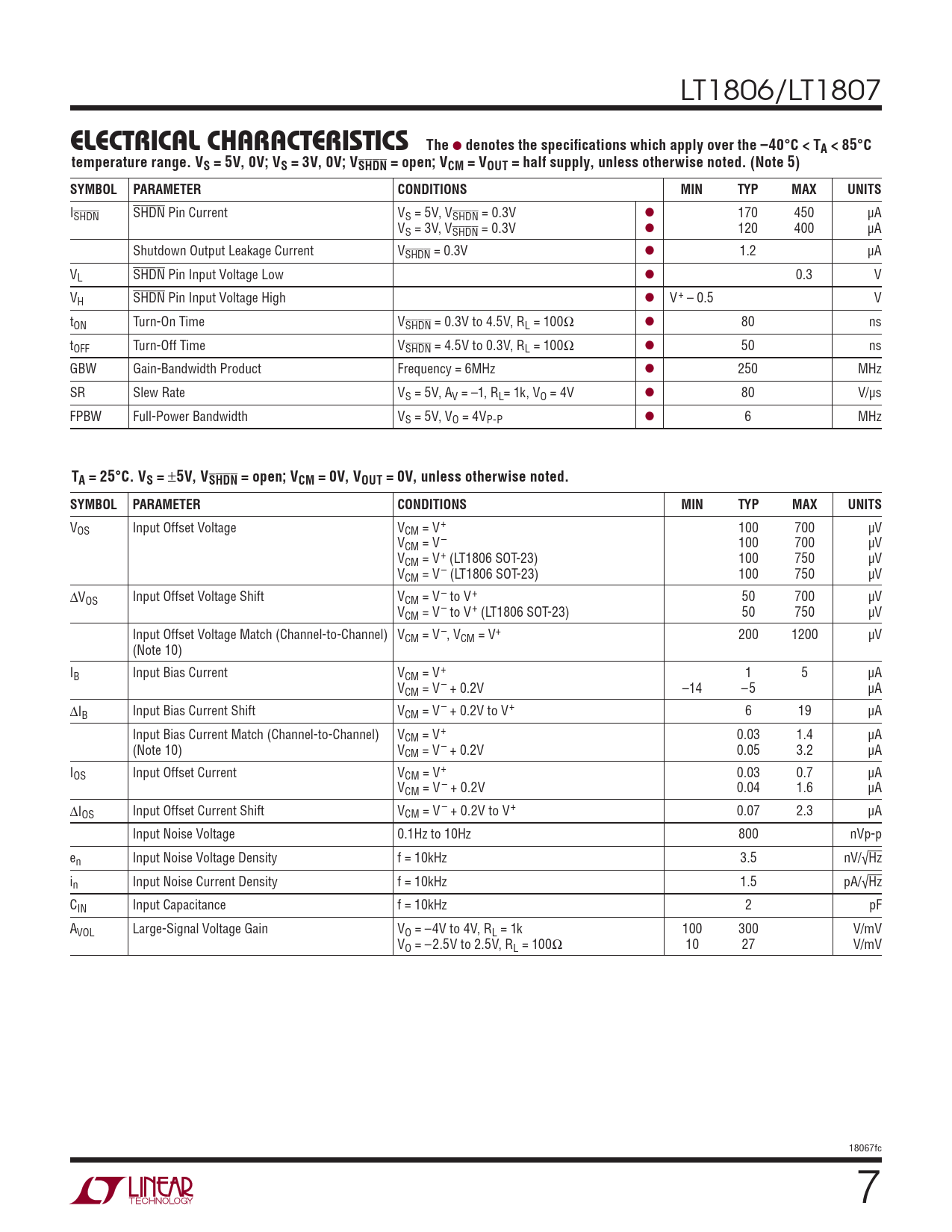

ELECTRICAL CHARACTERISTICS. The. denotes the specifi cations which apply over the –40°C < TA < 85°C
ELECTRICAL CHARACTERISTICS The denotes the specifi cations which apply over the –40°C < TA < 85°C
LT1806/LT1807
l
denotes the specifi cations which apply over the –40°C < TA < 85°C temperature range. VS = 5V, 0V; VS = 3V, 0V; VSHDN = open; VCM = VOUT = half supply, unless otherwise noted. (Note 5) SYMBOL PARAMETER CONDITIONS MIN TYP MAX UNITS
ISHDN SHDN Pin Current VS = 5V, VSHDN = 0.3V l 170 450 μA VS = 3V, VSHDN = 0.3V l 120 400 μA Shutdown Output Leakage Current VSHDN = 0.3V l 1.2 μA VL SHDN Pin Input Voltage Low l 0.3 V VH SHDN Pin Input Voltage High l V+ – 0.5 V tON Turn-On Time VSHDN = 0.3V to 4.5V, RL = 100Ω l 80 ns tOFF Turn-Off Time VSHDN = 4.5V to 0.3V, RL = 100Ω l 50 ns GBW Gain-Bandwidth Product Frequency = 6MHz l 250 MHz SR Slew Rate VS = 5V, AV = –1, RL= 1k, VO = 4V l 80 V/μs FPBW Full-Power Bandwidth VS = 5V, VO = 4VP-P l 6 MHz
TA = 25°C. VS =
5V, VSHDN = open; VCM = 0V, VOUT = 0V, unless otherwise noted. SYMBOL PARAMETER CONDITIONS MIN TYP MAX UNITS
VOS Input Offset Voltage VCM = V+ 100 700 μV VCM = V – 100 700 μV VCM = V+ (LT1806 SOT-23) 100 750 μV VCM = V – (LT1806 SOT-23) 100 750 μV ΔVOS Input Offset Voltage Shift VCM = V – to V+ 50 700 μV VCM = V – to V+ (LT1806 SOT-23) 50 750 μV Input Offset Voltage Match (Channel-to-Channel) VCM = V –, VCM = V+ 200 1200 μV (Note 10) IB Input Bias Current VCM = V+ 1 5 μA VCM = V – + 0.2V –14 –5 μA ΔIB Input Bias Current Shift VCM = V – + 0.2V to V+ 6 19 μA Input Bias Current Match (Channel-to-Channel) VCM = V+ 0.03 1.4 μA (Note 10) VCM = V – + 0.2V 0.05 3.2 μA IOS Input Offset Current VCM = V+ 0.03 0.7 μA VCM = V – + 0.2V 0.04 1.6 μA ΔIOS Input Offset Current Shift VCM = V – + 0.2V to V+ 0.07 2.3 μA Input Noise Voltage 0.1Hz to 10Hz 800 nVp-p en Input Noise Voltage Density f = 10kHz 3.5 nV/√Hz in Input Noise Current Density f = 10kHz 1.5 pA/√Hz CIN Input Capacitance f = 10kHz 2 pF AVOL Large-Signal Voltage Gain VO = –4V to 4V, RL = 1k 100 300 V/mV VO = –2.5V to 2.5V, RL = 100Ω 10 27 V/mV 18067fc 7
