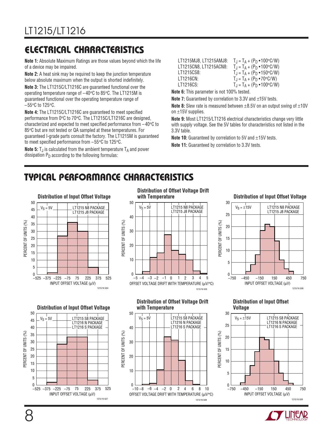

ELECTRICAL CH. ARA TERISTICS. Note 1:. Note 2:. Note 3:. Note 6:. Note 7:. Note 8:. Note 4:. Note 9:. Note 10:. Note 11:. Note 5:
ELECTRICAL CH ARA TERISTICS Note 1: Note 2: Note 3: Note 6: Note 7: Note 8: Note 4: Note 9: Note 10: Note 11: Note 5:
LT1215/LT1216
ELECTRICAL CH C ARA TERISTICS Note 1:
Absolute Maximum Ratings are those values beyond which the life LT1215MJ8, LT1215AMJ8: TJ = TA + (PD • 100°C/W) of a device may be impaired. LT1215CN8, LT1215ACN8: TJ = TA + (PD • 100°C/W)
Note 2:
A heat sink may be required to keep the junction temperature LT1215CS8: TJ = TA + (PD • 150°C/W) below absolute maximum when the output is shorted indefinitely. LT1216CN: TJ = TA + (PD • 70°C/W) LT1216CS: T
Note 3:
The LT1215C/LT1216C are guaranteed functional over the J = TA + (PD • 100°C/ W) operating temperature range of – 40°C to 85°C. The LT1215M is
Note 6:
This parameter is not 100% tested. guaranteed functional over the operating temperature range of
Note 7:
Guaranteed by correlation to 3.3V and ±15V tests. – 55°C to 125°C.
Note 8:
Slew rate is measured between ±8.5V on an output swing of ±10V
Note 4:
The LT1215C/LT1216C are guaranteed to meet specified on ±15V supplies. performance from 0°C to 70°C. The LT1215C/LT1216C are designed,
Note 9:
Most LT1215/LT1216 electrical characteristics change very little characterized and expected to meet specified performance from – 40°C to with supply voltage. See the 5V tables for characteristics not listed in the 85°C but are not tested or QA sampled at these temperatures. For 3.3V table. guaranteed I-grade parts consult the factory. The LT1215M is guaranteed
Note 10:
Guaranteed by correlation to 5V and ±15V tests. to meet specified performance from – 55°C to 125°C.
Note 11:
Guaranteed by correlation to 3.3V tests.
Note 5:
TJ is calculated from the ambient temperature TA and power dissipation PD according to the following formulas:
W U TYPICAL PERFOR A CE CH C ARA TERISTICS Distribution of Offset Voltage Drift Distribution of Input Offset Voltage with Temperature Distribution of Input Offset Voltage
50 50 30 V LT1215 N8 PACKAGE V LT1215 N8 PACKAGE V LT1215 N8 PACKAGE 45 S = 5V S = 5V S = ±15V LT1215 J8 PACKAGE LT1215 J8 PACKAGE LT1215 J8 PACKAGE 25 40 40 35 20 30 30 25 15 20 20 10 15 PERCENT OF UNITS (%) PERCENT OF UNITS (%) PERCENT OF UNITS (%) 10 10 5 5 0 0 0 –525 –375 –225 –75 75 225 375 525 –5 –4 –3 –2 –1 0 1 2 3 4 5 –750 –450 –150 150 450 750 INPUT OFFSET VOLTAGE (µV) OFFSET VOLTAGE DRIFT WITH TEMPERATURE (µV/°C) INPUT OFFSET VOLTAGE (µV) 1215/16 G04 1215/16 G05 1215/16 G06
Distribution of Offset Voltage Drift Distribution of Input Offset Distribution of Input Offset Voltage with Temperature Voltage
50 50 30 V LT1215 S8 PACKAGE V LT1215 S8 PACKAGE S = 5V S = 5V V LT1215 S8 PACKAGE S = ±15V 45 LT1216 N PACKAGE LT1216 N PACKAGE LT1216 N PACKAGE 25 40 LT1216 S PACKAGE 40 LT1216 S PACKAGE LT1216 S PACKAGE 35 20 30 30 25 15 20 20 10 15 PERCENT OF UNITS (%) PERCENT OF UNITS (%) PERCENT OF UNITS (%) 10 10 5 5 0 0 0 –525 –375 –225 –75 75 225 375 525 –10 –8 –6 –4 –2 0 2 4 6 8 10 –750 –450 –150 150 450 750 INPUT OFFSET VOLTAGE (µV) OFFSET VOLTAGE DRIFT WITH TEMPERATURE (µV/°C) INPUT OFFSET VOLTAGE (µV) 1215/16 G07 1215/16 G08 1215/16 G09 8
