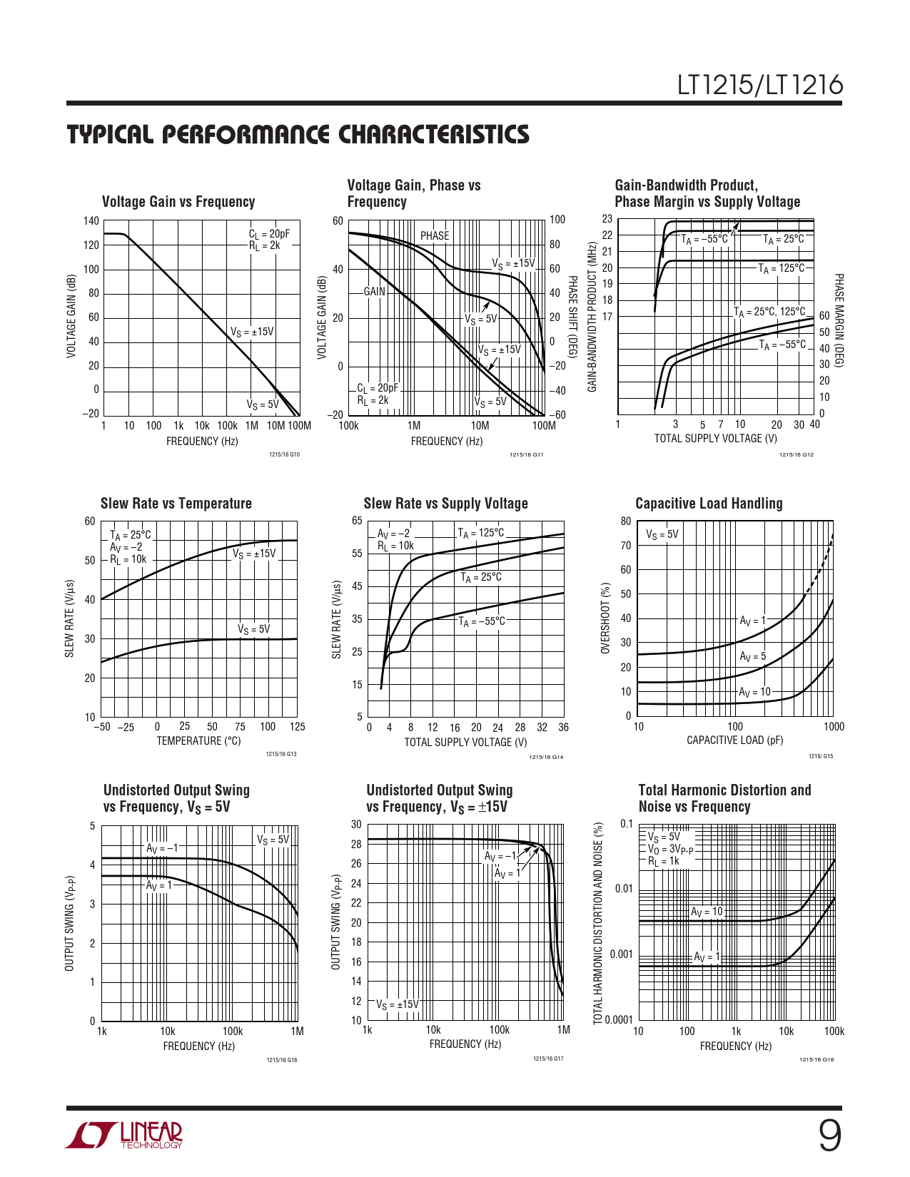

Description23MHz, 50V/µs, Single Supply Dual and Quad Precision Op Amps
Pages / Page20 / 9 — TYPICAL PERFOR A CE CH. ARA TERISTICS. Voltage Gain, Phase vs. …
File Format / SizePDF / 347 Kb
TYPICAL PERFOR A CE CH. ARA TERISTICS. Voltage Gain, Phase vs. Gain-Bandwidth Product,. Voltage Gain vs Frequency. Frequency
TYPICAL PERFOR A CE CH ARA TERISTICS Voltage Gain, Phase vs Gain-Bandwidth Product, Voltage Gain vs Frequency Frequency
LT1215/LT1216
W U TYPICAL PERFOR A CE CH C ARA TERISTICS Voltage Gain, Phase vs Gain-Bandwidth Product, Voltage Gain vs Frequency Frequency Phase Margin vs Supply Voltage
140 60 100 23 CL = 20pF PHASE 22 T 120 R 80 A = –55°C TA = 25°C L = 2k 21 V 100 40 S = ±15V 60 PHASE SHIFT (DEG) 20 TA = 125°C PHASE MARGIN (DEG) 19 80 GAIN 40 18 T 60 20 V 20 17 A = 25°C, 125°C 60 S = 5V VS = ±15V 50 40 0 T V A = –55°C 40 VOLTAGE GAIN (dB) VOLTAGE GAIN (dB) S = ±15V 20 0 –20 30 20 0 CL = 20pF –40 GAIN-BANDWIDTH PRODUCT (MHz) R 10 L = 2k V V S = 5V S = 5V –20 –20 –60 0 1 10 100 1k 10k 100k 1M 10M 100M 100k 1M 10M 100M 1 3 5 7 10 20 30 40 FREQUENCY (Hz) FREQUENCY (Hz) TOTAL SUPPLY VOLTAGE (V) 1215/16 G10 1215/16 G11 1215/16 G12
Slew Rate vs Temperature Slew Rate vs Supply Voltage Capacitive Load Handling
60 65 80 T T A = 25°C AV = –2 A = 125°C VS = 5V AV = –2 RL = 10k 70 V 55 50 S = ±15V RL = 10k 60 TA = 25°C µs) µs) 45 50 40 35 T 40 A = –55°C AV = 1 VS = 5V 30 30 SLEW RATE (V/ SLEW RATE (V/ 25 OVERSHOOT (%) AV = 5 20 20 15 10 AV = 10 10 5 0 –50 –25 0 25 50 75 100 125 0 4 8 12 16 20 24 28 32 36 10 100 1000 TEMPERATURE (°C) TOTAL SUPPLY VOLTAGE (V) CAPACITIVE LOAD (pF) 1215/16 G13 1215/16 G14 1216/ G15
Undistorted Output Swing Undistorted Output Swing Total Harmonic Distortion and vs Frequency, VS = 5V vs Frequency, VS =
15V Noise vs Frequency
5 30 0.1 V V S = 5V S = 5V A 28 V = –1 VO = 3VP-P AV = –1 4 R 26 L = 1k ) AV = 1 24 P-P AV = 1 P-P 0.01 3 22 AV = 10 20 2 18 0.001 AV = 1 16 OUTPUT SWING (V OUTPUT SWING (V 1 14 12 VS = ±15V 0 10 TOTAL HARMONIC DISTORTION AND NOISE (%) 0.0001 1k 10k 100k 1M 1k 10k 100k 1M 10 100 1k 10k 100k FREQUENCY (Hz) FREQUENCY (Hz) FREQUENCY (Hz) 1215/16 G16 1215/16 G17 1215/16 G18 9
