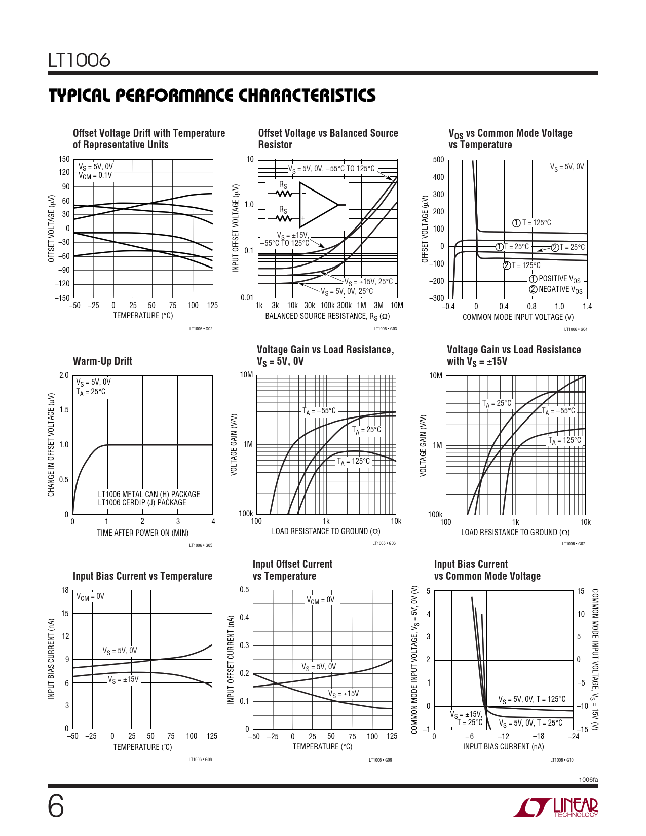

TYPICAL PERFOR A CE CHARACTERISTICS. Offset Voltage Drift with Temperature. Offset Voltage vs Balanced Source
TYPICAL PERFOR A CE CHARACTERISTICS Offset Voltage Drift with Temperature Offset Voltage vs Balanced Source
LT1006
W U TYPICAL PERFOR A CE CHARACTERISTICS Offset Voltage Drift with Temperature Offset Voltage vs Balanced Source VOS vs Common Mode Voltage of Representative Units Resistor vs Temperature
150 10 500 V V S = 5V, 0V V S = 5V, 0V S = 5V, 0V, – 55°C TO 125°C 120 VCM = 0.1V 400 R 90 V) S µ – 300 V) µ 60 1.0 µV) RS 200 30 + 1 T = 125°C 0 100 VS = ±15V, –30 – 55°C TO 125°C 0 1 T = 25°C 2 T = 25°C 0.1 –60 OFFSET VOLTAGE ( OFFSET VOLTAGE ( –100 2 T = 125°C –90 INPUT OFFSET VOLTAGE ( V –200 1 POSITIVE VOS –120 S = ±15V, 25°C 2 NEGATIVE V V OS S = 5V, 0V, 25°C –150 0.01 –300 –50 –25 0 25 50 75 100 125 1k 3k 10k 30k 100k 300k 1M 3M 10M –0.4 0 0.4 0.8 1.0 1.4 TEMPERATURE (°C) BALANCED SOURCE RESISTANCE, RS (Ω) COMMON MODE INPUT VOLTAGE (V) LT1006 • G02 LT1006 • G03 LT1006 • G04
Voltage Gain vs Load Resistance, Voltage Gain vs Load Resistance Warm-Up Drift V with V S = 5V, 0V S =
15V
2.0 10M 10M VS = 5V, 0V T V) A = 25°C µ TA = 25°C 1.5 TA = –55°C TA = –55°C TA = 25°C T 1.0 1M 1M A = 125°C TA = 125°C VOLTAGE GAIN (V/V) VOLTAGE GAIN (V/V) 0.5 CHANGE IN OFFSET VOLTAGE ( LT1006 METAL CAN (H) PACKAGE LT1006 CERDIP (J) PACKAGE 0 100k 100k 0 1 2 3 4 100 1k 10k 100 1k 10k LOAD RESISTANCE TO GROUND ( TIME AFTER POWER ON (MIN) Ω) LOAD RESISTANCE TO GROUND (Ω) LT1006 • G06 LT1006 • G07 LT1006 • G05
Input Offset Current Input Bias Current Input Bias Current vs Temperature vs Temperature vs Common Mode Voltage
COMMON MODE INPUT VOLTAGE, V 18 0.5 5 15 VCM = 0V VCM = 0V 15 4 10 0.4 = 5V, 0V (V) S 12 3 5 0.3 VS = 5V, 0V 9 2 0 VS = 5V, 0V 0.2 V 6 S = ±15V 1 –5 VS = ±15V S INPUT BIAS CURRENT (nA) V = 15V (V) INPUT OFFSET CURRENT (nA) 0.1 S = 5V, 0V, T = 125°C 3 0 –10 VS = ±15V, T = 25°C VS = 5V, 0V, T = 25°C 0 0 –1 COMMON MODE INPUT VOLTAGE, V –15 –50 –25 0 25 50 75 100 125 –50 –25 0 25 50 75 100 125 0 – 6 –12 –18 –24 TEMPERATURE (˚C) TEMPERATURE (°C) INPUT BIAS CURRENT (nA) LT1006 • G08 LT1006 • G09 LT1006 • G10 1006fa 6
