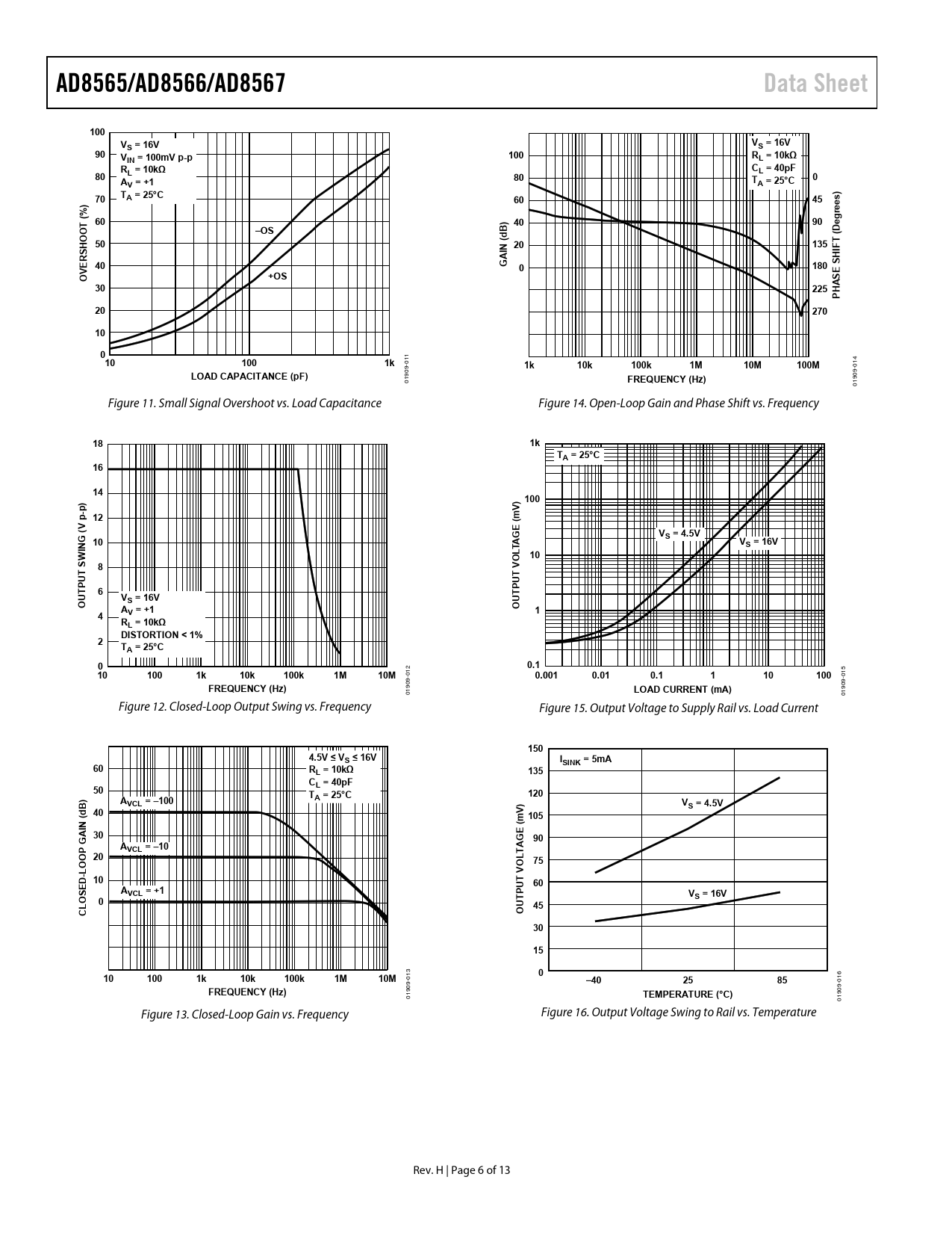

AD8565/AD8566/AD8567. Data Sheet. 100. S = 16V. IN = 100mV p-p. L = 10kΩ. CL = 40pF. V = +1. A = 25°C. TA = 25°C. es). ) 40. –OS. OOT (. d (. H 50. 135
AD8565/AD8566/AD8567 Data Sheet 100 S = 16V IN = 100mV p-p L = 10kΩ CL = 40pF V = +1 A = 25°C TA = 25°C es) ) 40 –OS OOT ( d ( H 50 135
AD8565/AD8566/AD8567 Data Sheet 100 V V S = 16V S = 16V 90 V 100 R IN = 100mV p-p L = 10kΩ R CL = 40pF 80 L = 10kΩ 0 A 80 T V = +1 A = 25°C 70 TA = 25°C 45 ) 60 es) % re 60 ) 40 90 eg –OS B (D OOT ( d ( T H 50 20 135 S IN IF R H E 40 GA 0 180 S E OV +OS 30 225 HAS P 20 270 10 010 100 1k

01 Figure 11. Small Signal Overshoot vs. Load Capacitance Figure 14. Open-Loop Gain and Phase Shift vs. Frequency
18 1k TA = 25°C 16 14 ) 100 p V) p- 12 m V E ( V G ( G S = 4.5V 10 V IN S = 16V LTA W 10 S 8 T VO T U U TP P 6 T V U OU S = 16V A O 1 4 V = +1 RL = 10kΩ DISTORTION < 1% 2 TA = 25°C 0 0.1 10 100 1k 10k 100k 1M 10M

909 019 01 Figure 12. Closed-Loop Output Swing vs. Frequency Figure 15. Output Voltage to Supply Rail vs. Load Current
150 4.5V ≤ VS ≤ 16V ISINK = 5mA 60 RL = 10kΩ 135 CL = 40pF 50 120 ) TA = 25°C A B VCL = –100 ) V V S = 4.5V (d 40 105 IN (m 30 GE 90 GA AVCL = –10 20 LTA OOP O 75 -L V D 10 T E U 60 AVCL = +1 V OS TP S = 16V L 0 45 C OU 30 15

019 190 0 Figure 13. Closed-Loop Gain vs. Frequency Figure 16. Output Voltage Swing to Rail vs. Temperature Rev. H | Page 6 of 13 Document Outline FEATURES APPLICATIONS GENERAL DESCRIPTION PIN CONFIGURATIONS TABLE OF CONTENTS REVISION HISTORY SPECIFICATIONS ELECTRICAL CHARACTERISTICS ABSOLUTE MAXIMUM RATINGS THERMAL RESISTANCE ESD CAUTION TYPICAL PERFORMANCE CHARACTERISTICS THEORY OF OPERATION INPUT OVERVOLTAGE PROTECTION OUTPUT PHASE REVERSAL POWER DISSIPATION THERMAL PAD—AD8567 TOTAL HARMONIC DISTORTION + NOISE (THD + N) SHORT-CIRCUIT OUTPUT CONDITIONS LCD PANEL APPLICATIONS OUTLINE DIMENSIONS ORDERING GUIDE
