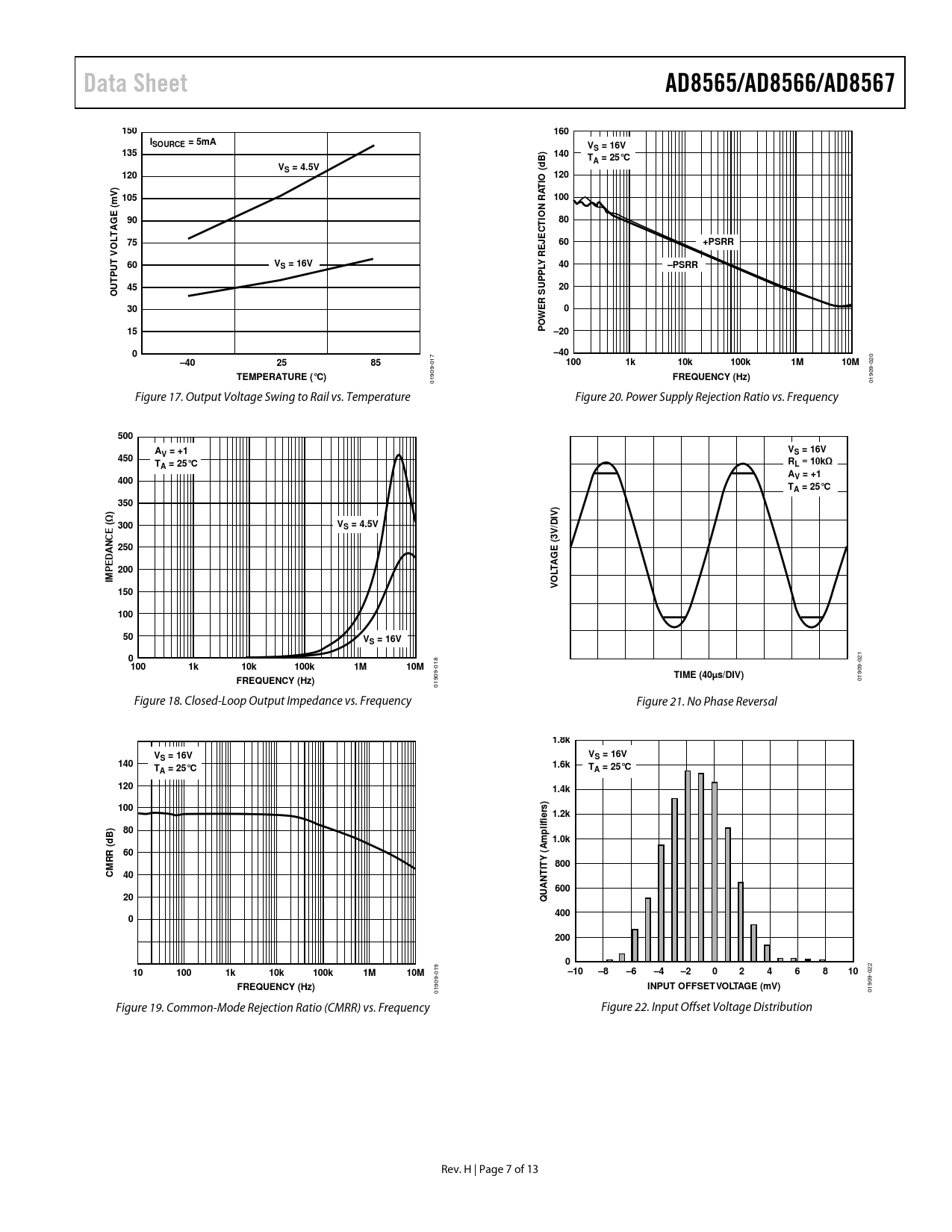

Pages / Page13 / 7 — Data Sheet. AD8565/AD8566/AD8567. 150. 160. ISOURCE = 5mA. VS = 16V. 135. …

01909- 01909- Figure 17. Output Voltage Swing to Rail vs. Temperature Figure 20. Power Supply Rejection Ratio vs. Frequency

01909- 01909- Figure 18. Closed-Loop Output Impedance vs. Frequency Figure 21. No Phase Reversal

01909- 01909- Figure 19. Common-Mode Rejection Ratio (CMRR) vs. Frequency Figure 22. Input Offset Voltage Distribution Rev. H | Page 7 of 13 Document Outline FEATURES APPLICATIONS GENERAL DESCRIPTION PIN CONFIGURATIONS TABLE OF CONTENTS REVISION HISTORY SPECIFICATIONS ELECTRICAL CHARACTERISTICS ABSOLUTE MAXIMUM RATINGS THERMAL RESISTANCE ESD CAUTION TYPICAL PERFORMANCE CHARACTERISTICS THEORY OF OPERATION INPUT OVERVOLTAGE PROTECTION OUTPUT PHASE REVERSAL POWER DISSIPATION THERMAL PAD—AD8567 TOTAL HARMONIC DISTORTION + NOISE (THD + N) SHORT-CIRCUIT OUTPUT CONDITIONS LCD PANEL APPLICATIONS OUTLINE DIMENSIONS ORDERING GUIDE
