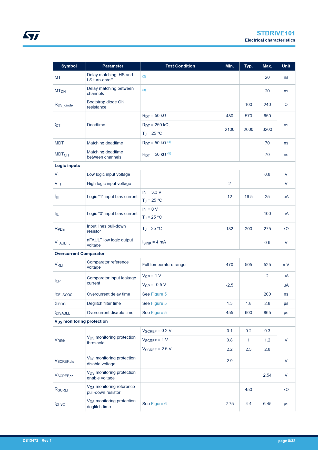

Datasheet STDRIVE101 (STMicroelectronics) - 8
DescriptionTriple half-bridge gate driver
Pages / Page32 / 8 — STDRIVE101. Electrical characteristics. Symbol. Parameter. Test …
File Format / SizePDF / 899 Kb
STDRIVE101. Electrical characteristics. Symbol. Parameter. Test Condition. Min. Typ. Max. Unit. Logic inputs. Overcurrent Comparator
STDRIVE101 Electrical characteristics Symbol Parameter Test Condition Min Typ Max Unit Logic inputs Overcurrent Comparator
link to page 9 link to page 9 link to page 9 link to page 9 link to page 10 link to page 10 link to page 10 link to page 10
STDRIVE101 Electrical characteristics Symbol Parameter Test Condition Min. Typ. Max. Unit
Delay matching, HS and MT (2) 20 ns LS turn-on/off MT Delay matching between CH (3) 20 ns channels R Bootstrap diode ON DS_diode 100 240 Ω resistance RDT = 50 kΩ 480 570 650 tDT Deadtime RDT = 250 kΩ; ns 2100 2600 3200 TJ = 25 °C MDT Matching deadtime RDT = 50 kΩ (4) 70 ns MDT Matching deadtime CH R between channels DT = 50 kΩ (5) 70 ns
Logic inputs
VIL Low logic input voltage 0.8 V VIH High logic input voltage 2 V IN = 3.3 V IIH Logic “1” input bias current 12 16.5 25 µA TJ = 25 °C IN = 0 V IIL Logic “0” input bias current 100 nA TJ = 25 °C R Input lines pull-down PDin T resistor J = 25 °C 132 200 275 kΩ V nFAULT low logic output FAULT,L I voltage SINK = 4 mA 0.6 V
V Comparator reference REF Full temperature range 470 505 525 mV voltage VCP = 1 V 2 µA I Comparator input leakage CP current VCP = -0.5 V -2.5 µA tDELAY,OC Overcurrent delay time See Figure 5 200 ns tDFOC Deglitch filter time See Figure 5 1.3 1.8 2.8 µs tDISABLE Overcurrent disable time See Figure 5 455 600 865 µs
VDS monitoring protection
VSCREF = 0.2 V 0.1 0.2 0.3 V V DS monitoring protection DSth VSCREF = 1 V 0.8 1 1.2 V threshold VSCREF = 2.5 V 2.2 2.5 2.8 V V DS monitoring protection SCREF,dis 2.9 V disable voltage V V DS monitoring protection SCREF,en 2.54 V enable voltage V R DS monitoring reference SCREF 450 kΩ pull-down resistor V t DS monitoring protection DFSC See Figure 6 2.75 4.4 6.45 µs deglitch time
