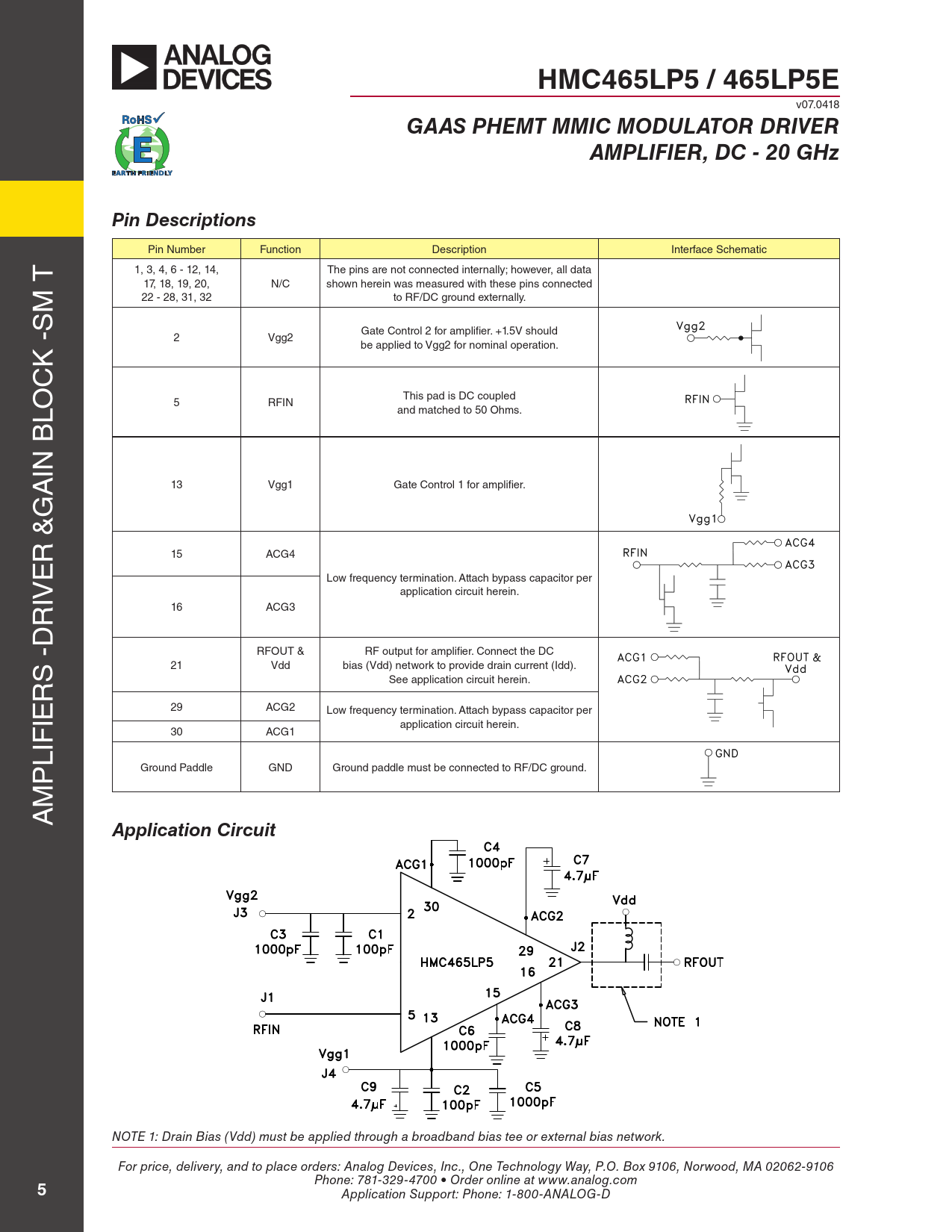

DescriptionGaAs PHEMT MMIC MODULATOR DRIVER AMPLIFIER, DC - 20 GHz
Pages / Page8 / 5 — HMC465LP5 / 465LP5E. GAAS PHEMT MMIC MODULATOR DRIVER. AMPLIFIER, DC - 20 …
HMC465LP5 / 465LP5E. GAAS PHEMT MMIC MODULATOR DRIVER. AMPLIFIER, DC - 20 GHz. Pin Descriptions. Application Circuit
HMC465LP5 / 465LP5E GAAS PHEMT MMIC MODULATOR DRIVER AMPLIFIER, DC - 20 GHz Pin Descriptions Application Circuit
HMC465LP5 / 465LP5E
v07.0418
pin number function Description interface schematic T 1, 3, 4, 6 - 12, 14, The pins are not connected internally; however, all data 17, 18, 19, 20, n/c shown herein was measured with these pins connected m 22 - 28, 31, 32 to rf/Dc ground externally. s Gate control 2 for amplifier. +1.5v should 2 vgg2 k - be applied to vgg2 for nominal operation. c This pad is Dc coupled lo 5 rfin and matched to 50 ohms. in B A 13 vgg1 Gate control 1 for amplifier. G r & 15 AcG4 e low frequency termination. Attach bypass capacitor per iv application circuit herein. r 16 AcG3 D rfoUT & rf output for amplifier. connect the Dc s - 21 vdd bias (vdd) network to provide drain current (idd). r see application circuit herein. ie 29 AcG2 low frequency termination. Attach bypass capacitor per application circuit herein. 30 AcG1 lif p Ground paddle GnD Ground paddle must be connected to rf/Dc ground. m A
Application Circuit
NOTE 1: Drain Bias (Vdd) must be applied through a broadband bias tee or external bias network. For price, delivery, and to place orders: Analog Devices, Inc., One Technology Way, P.O. Box 9106, Norwood, MA 02062-9106 Phone: 781-329-4700 • Order online at www.analog.com
