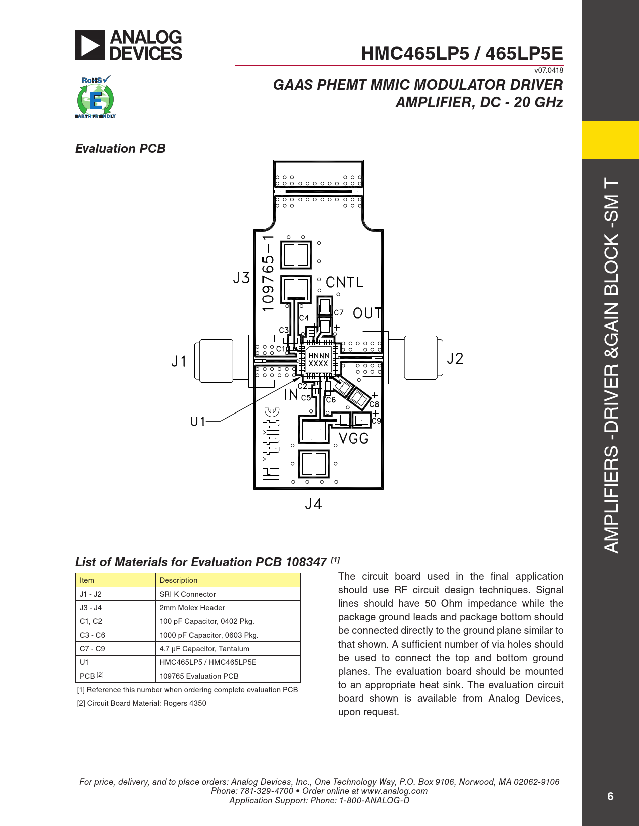

List of Materials for Evaluation PCB 108347 [1]
The circuit board used in the final application item Description should use rf circuit design techniques. signal J1 - J2 sri k connector lines should have 50 ohm impedance while the J3 - J4 2mm molex Header package ground leads and package bottom should c1, c2 100 pf capacitor, 0402 pkg. be connected directly to the ground plane similar to c3 - c6 1000 pf capacitor, 0603 pkg. that shown. A sufficient number of via holes should c7 - c9 4.7 µf capacitor, Tantalum be used to connect the top and bottom ground U1 Hmc465lp5 / Hmc465lp5e planes. The evaluation board should be mounted pcB [2] 109765 evaluation pcB to an appropriate heat sink. The evaluation circuit [1] reference this number when ordering complete evaluation pcB board shown is available from Analog Devices, [2] circuit Board material: rogers 4350 upon request. For price, delivery, and to place orders: Analog Devices, Inc., One Technology Way, P.O. Box 9106, Norwood, MA 02062-9106 Phone: 781-329-4700 • Order online at www.analog.com Application Support: Phone: 1-800-ANALOG-D
