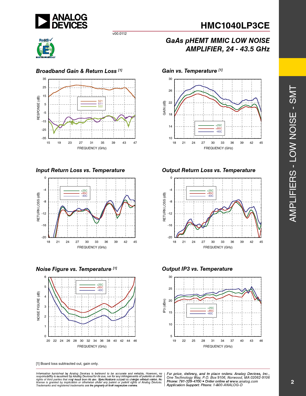

HMC1040LP3CE. GaAs pHEMT MMIC LOW NOISE. AMPLIFIER, 24 - 43.5 GHz. Broadband Gain & Return Loss [1]
HMC1040LP3CE GaAs pHEMT MMIC LOW NOISE AMPLIFIER, 24 - 43.5 GHz Broadband Gain & Return Loss [1]
HMC1040LP3CE
v00.0112
GaAs pHEMT MMIC LOW NOISE AMPLIFIER, 24 - 43.5 GHz Broadband Gain & Return Loss [1] Gain vs. Temperature [1]
35 30 25 26 T 15 m (dB) S21 5 S11 22 s S22 (dB) -5 GAIN 18 e - RESPONSE -15 14 +25C is -25 +85C -40C o -35 10 15 19 23 27 31 35 39 43 47 18 21 24 27 30 33 36 39 42 45 FREQUENCY (GHz) FREQUENCY (GHz) w N lo
Input Return Loss vs. Temperature Output Return Loss vs. Temperature
s - 0 0 r -4 +25C -4 +25C ie +85C +85C -40C (dB) -40C (dB) -8 -8 lif LOSS LOSS p -12 -12 m RETURN RETURN A -16 -16 -20 -20 18 21 24 27 30 33 36 39 42 45 18 21 24 27 30 33 36 39 42 45 FREQUENCY (GHz) FREQUENCY (GHz)
Noise Figure vs. Temperature [1] Output IP3 vs. Temperature
6 30 +25C 5 +85C -40C 25 ) (dB 4 E ) R 20 U IG 3 (dBm F +25C E IP3 15 +85C IS -40C 2 O N 10 1 0 5 20 22 24 26 28 30 32 34 36 38 40 42 44 46 19 22 25 28 31 34 37 40 43 46 FREQUENCY (GHz) FREQUENCY (GHz) [1] Board loss subtracted out, gain only. Inf F or o m r p atio r n ifc ur e n , d ishe e d lbiv y e A r n y a alog n D d t evic o p es is la beclie o eved rd to ebre sa: H ccur iattti e tae M nd re ilicarbloew . H a o ve C wever, o n rp o For price, delivery, and to place orders: Analog Devices, Inc., responsibility is assumed by Analog Devices for its use, nor for any infringements of patents or other oration, 2 Elizabeth Drive, Chelmsford, MA 01824 One Technology Way, P.O. Box 9106, Norwood, MA 02062-9106 Phone: 978-250-3343 Fax: 978-250-3373 O rights of third parties that may result from its use. Specifications subject to change without notice. No P rd ho e ne r O : 7 n 81- -3li 2n 9 e a -47 t w 0 w 0 • O w rd .h e it r o tniltie n .c e ao t m license is granted by implication or otherwise under any patent or patent rights of Analog Devices. www.analog.com
