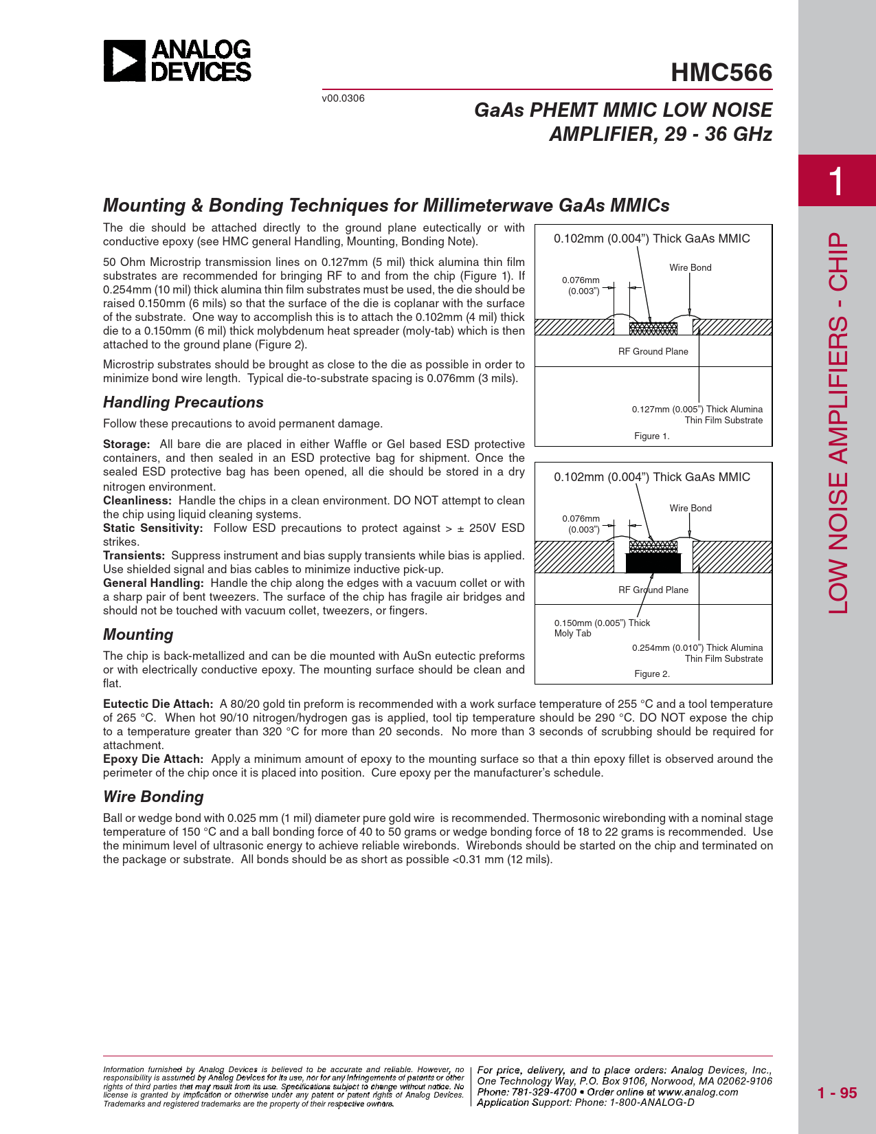

The die should be attached directly to the ground plane eutectically or with conductive epoxy (see HMC general Handling, Mounting, Bonding Note). 0.102mm (0.004”) Thick GaAs MMIC IP 50 Ohm Microstrip transmission lines on 0.127mm (5 mil) thick alumina thin fi lm Wire Bond H substrates are recommended for bringing RF to and from the chip (Figure 1). If 0.076mm 0.254mm (10 mil) thick alumina thin fi lm substrates must be used, the die should be (0.003”) C raised 0.150mm (6 mils) so that the surface of the die is coplanar with the surface - of the substrate. One way to accomplish this is to attach the 0.102mm (4 mil) thick die to a 0.150mm (6 mil) thick molybdenum heat spreader (moly-tab) which is then attached to the ground plane (Figure 2). RF Ground Plane RS Microstrip substrates should be brought as close to the die as possible in order to IE minimize bond wire length. Typical die-to-substrate spacing is 0.076mm (3 mils). IF

Moly Tab 0.254mm (0.010”) Thick Alumina The chip is back-metallized and can be die mounted with AuSn eutectic preforms Thin Film Substrate or with electrically conductive epoxy. The mounting surface should be clean and Figure 2. fl at.
