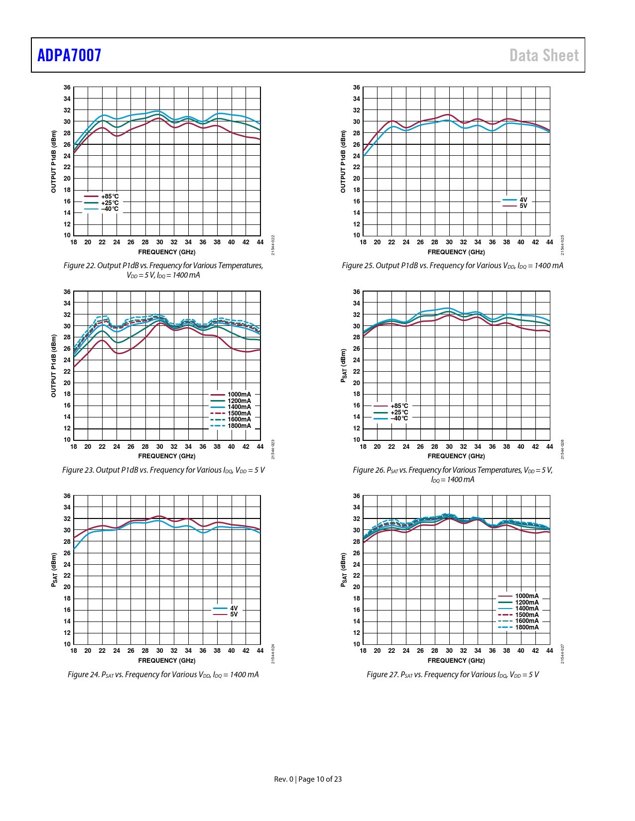

ADPA7007. Data Sheet. Bm). B (. +85°C. +25°C. –40°C. FREQUENCY (GHz). Bm) d. d (. UT O. 1000mA. 1200mA. 1400mA. 1500mA. 1600mA. 1800mA. 1000mA 1200mA
ADPA7007 Data Sheet Bm) B ( +85°C +25°C –40°C FREQUENCY (GHz) Bm) d d ( UT O 1000mA 1200mA 1400mA 1500mA 1600mA 1800mA 1000mA 1200mA
ADPA7007 Data Sheet 36 36 34 34 32 32 30 30 28 28 Bm) Bm) d 26 d 26 B ( B ( 24 24 1d 1d P 22 P 22 UT UT P 20 P 20 UT UT O 18 O 18 +85°C 16 4V +25°C 16 5V –40°C 14 14 12 12 10 10 18 20 22 24 26 28 30 32 34 36 38 40 42 44

21544- Figure 22. Output P1dB vs. Frequency for Various Temperatures, Figure 25. Output P1dB vs. Frequency for Various VDD, IDQ = 1400 mA VDD = 5 V, IDQ = 1400 mA

21544- Figure 23. Output P1dB vs. Frequency for Various IDQ, VDD = 5 V Figure 26. PSAT vs. Frequency for Various Temperatures, VDD = 5 V, IDQ = 1400 mA

21544- Figure 24. PSAT vs. Frequency for Various VDD, IDQ = 1400 mA Figure 27. PSAT vs. Frequency for Various IDQ, VDD = 5 V Rev. 0 | Page 10 of 23 Document Outline FEATURES APPLICATIONS FUNCTIONAL BLOCK DIAGRAM GENERAL DESCRIPTION TABLE OF CONTENTS REVISION HISTORY SPECIFICATIONS 20 GHz TO 26 GHz FREQUENCY RANGE 26 GHz TO 34 GHz FREQUENCY RANGE 34 GHz TO 44 GHz FREQUENCY RANGE ABSOLUTE MAXIMUM RATINGS ELECTROSTATIC DISCHARGE (ESD) RATINGS ESD CAUTION PIN CONFIGURATION AND FUNCTION DESCRIPTIONS INTERFACE SCHEMATICS TYPICAL PERFORMANCE CHARACTERISTICS CONSTANT IDD OPERATION THEORY OF OPERATION APPLICATIONS INFORMATION BIASING ADPA7007 WITH THE HMC980LP4E APPLICATION CIRCUIT SETUP LIMITING VGATE AND VNEG FOR ADPA7007 VGGX ABSOLUTE MAXIMUM RATING REQUIREMENT HMC980LP4E BIAS SEQUENCE Power-Up Sequence Power-Down Sequence CONSTANT DRAIN CURRENT BIASING vs. CONSTANT GATE VOLTAGE BIASING OUTLINE DIMENSIONS ORDERING GUIDE
