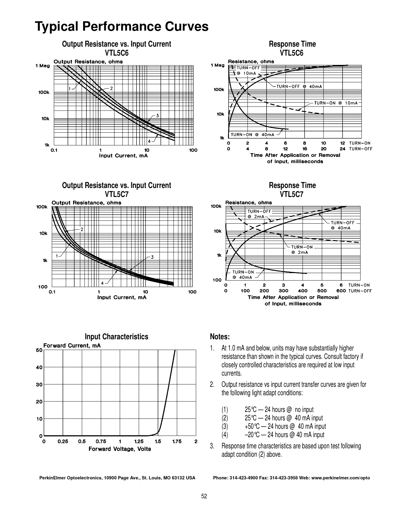

Typical Performance Curves. Output Resistance vs. Input Current. Response Time. VTL5C6. VTL5C7. Input Characteristics. Notes:
Typical Performance Curves Output Resistance vs Input Current Response Time VTL5C6 VTL5C7 Input Characteristics Notes:
Typical Performance Curves Output Resistance vs. Input Current Response Time VTL5C6 VTL5C6 Output Resistance vs. Input Current Response Time VTL5C7 VTL5C7 Input Characteristics Notes:
1. At 1.0 mA and below, units may have substantial y higher resistance than shown in the typical curves. Consult factory if closely control ed characteristics are required at low input currents. 2. Output resistance vs input current transfer curves are given for the fol owing light adapt conditions: (1) 25°C — 24 hours @ no input (2) 25°C — 24 hours @ 40 mA input (3) +50°C — 24 hours @ 40 mA input (4) –20°C — 24 hours @ 40 mA input 3. Response time characteristics are based upon test fol owing adapt condition (2) above.
