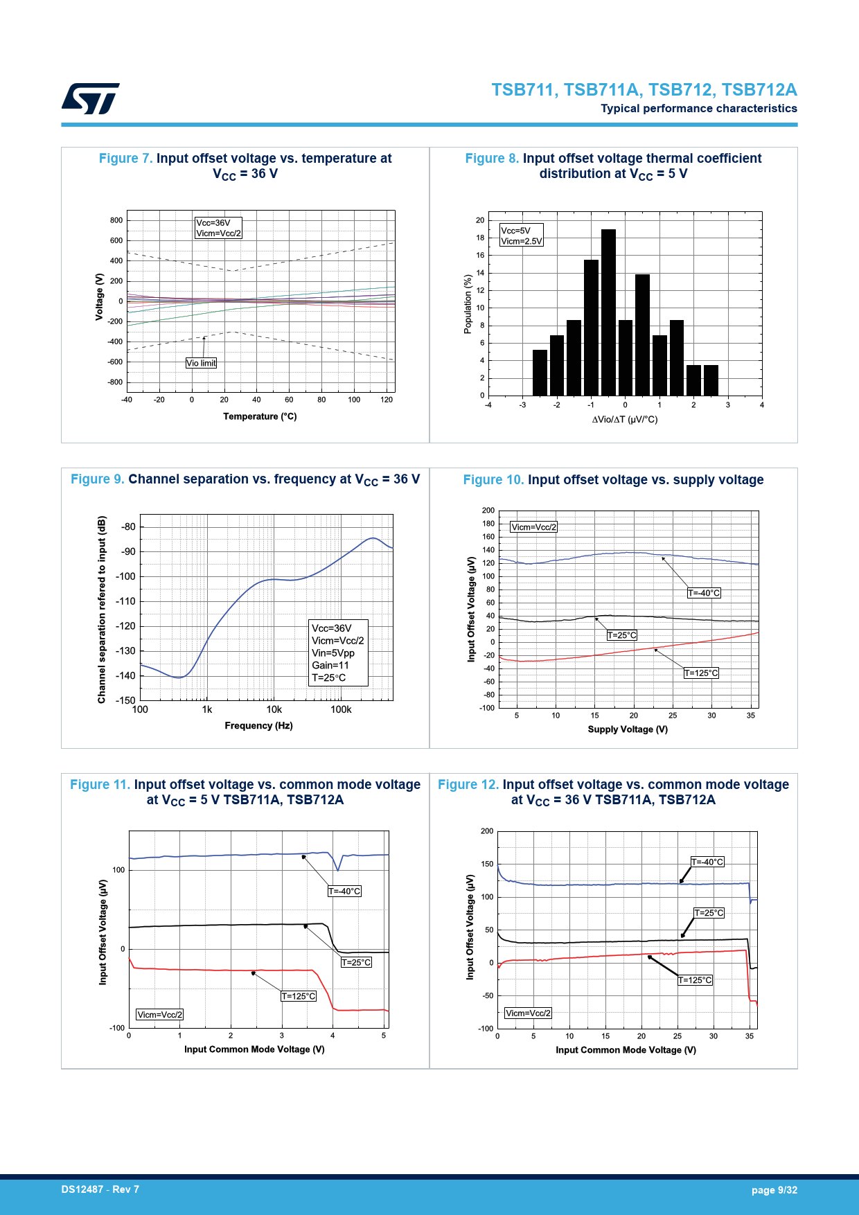

TSB711, TSB711A, TSB712, TSB712A. Typical performance characteristics. Figure 7. Input offset voltage vs. temperature at
TSB711, TSB711A, TSB712, TSB712A Typical performance characteristics Figure 7 Input offset voltage vs temperature at
TSB711, TSB711A, TSB712, TSB712A Typical performance characteristics Figure 7. Input offset voltage vs. temperature at Figure 8. Input offset voltage thermal coefficient VCC = 36 V distribution at VCC = 5 V Figure 9. Channel separation vs. frequency at VCC = 36 V Figure 10. Input offset voltage vs. supply voltage Figure 11. Input offset voltage vs. common mode voltage Figure 12. Input offset voltage vs. common mode voltage at VCC = 5 V TSB711A, TSB712A at VCC = 36 V TSB711A, TSB712A DS12487
