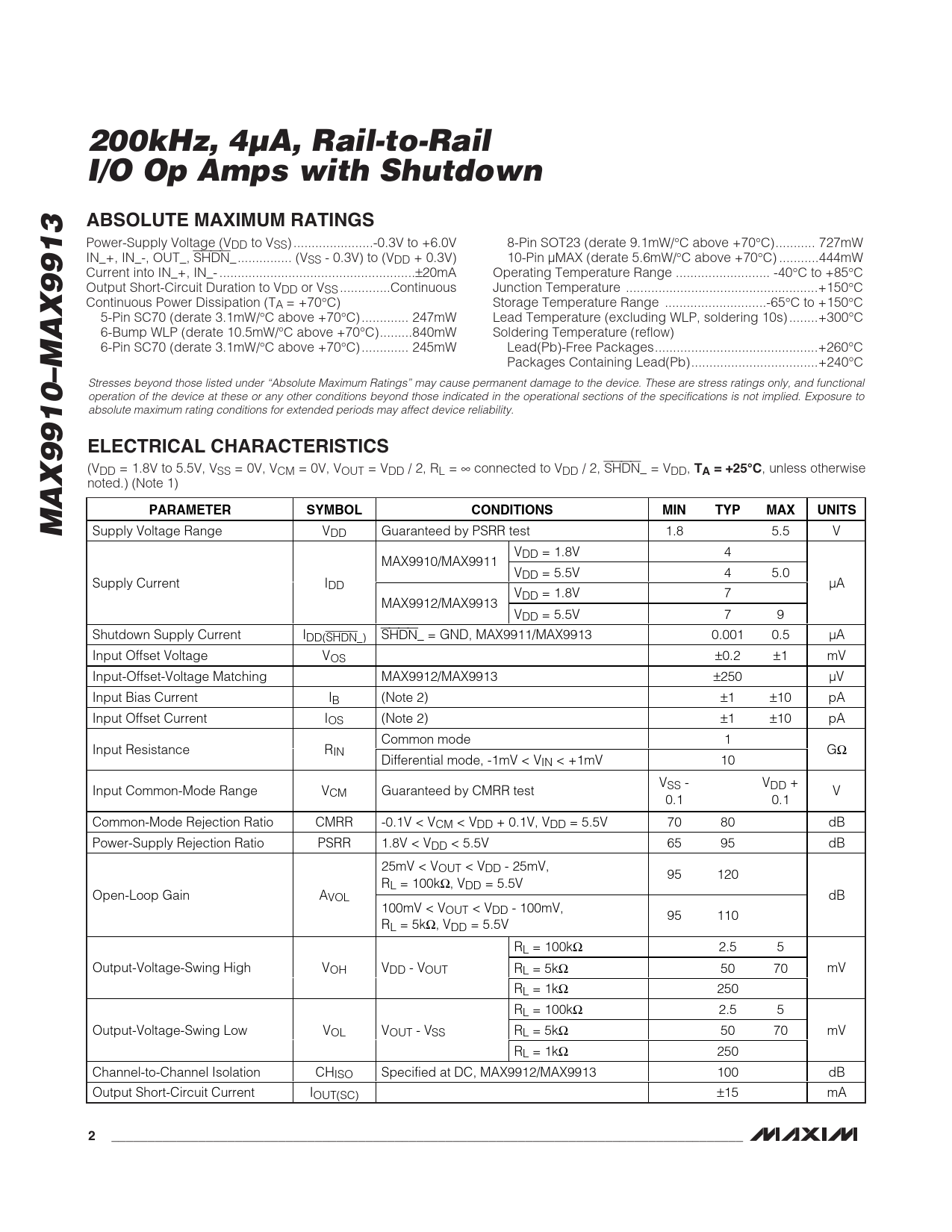

200kHz, 4µA, Rail-to-Rail I/O Op Amps with Shutdown. ABSOLUTE MAXIMUM RATINGS. ELECTRICAL CHARACTERISTICS. TA = +25°C
200kHz, 4µA, Rail-to-Rail I/O Op Amps with Shutdown ABSOLUTE MAXIMUM RATINGS ELECTRICAL CHARACTERISTICS TA = +25°C
Power-Supply Voltage (VDD to VSS) ..-0.3V to +6.0V 8-Pin SOT23 (derate 9.1mW/°C above +70°C)... 727mW IN_+, IN_-, OUT_, SHDN_... (VSS - 0.3V) to (VDD + 0.3V) 10-Pin µMAX (derate 5.6mW/°C above +70°C) ...444mW Current into IN_+, IN_- ..±20mA Operating Temperature Range .. -40°C to +85°C Output Short-Circuit Duration to VDD or VSS ..Continuous Junction Temperature ...+150°C Continuous Power Dissipation (TA = +70°C) Storage Temperature Range ..-65°C to +150°C 5-Pin SC70 (derate 3.1mW/°C above +70°C) ... 247mW Lead Temperature (excluding WLP, soldering 10s) ..+300°C 6-Bump WLP (derate 10.5mW/°C above +70°C)...840mW Soldering Temperature (reflow) 6-Pin SC70 (derate 3.1mW/°C above +70°C) ... 245mW Lead(Pb)-Free Packages...+260°C Packages Containing Lead(Pb)...+240°C Stresses beyond those listed under “Absolute Maximum Ratings” may cause permanent damage to the device. These are stress ratings only, and functional operation of the device at these or any other conditions beyond those indicated in the operational sections of the specifications is not implied. Exposure to absolute maximum rating conditions for extended periods may affect device reliability.
(VDD = 1.8V to 5.5V, VSS = 0V, VCM = 0V, VOUT = VDD / 2, RL = ∞ connected to VDD / 2, SHDN_ = VDD,
TA = +25°C
, unless otherwise noted.) (Note 1)
PARAMETER SYMBOL CONDITIONS MIN TYP MAX UNITS MAX9910–MAX9913
Supply Voltage Range VDD Guaranteed by PSRR test 1.8 5.5 V VDD = 1.8V 4 MAX9910/MAX9911 VDD = 5.5V 4 5.0 Supply Current IDD µA VDD = 1.8V 7 MAX9912/MAX9913 VDD = 5.5V 7 9 Shutdown Supply Current IDD(SHDN_) SHDN_ = GND, MAX9911/MAX9913 0.001 0.5 µA Input Offset Voltage VOS ±0.2 ±1 mV Input-Offset-Voltage Matching MAX9912/MAX9913 ±250 µV Input Bias Current IB (Note 2) ±1 ±10 pA Input Offset Current IOS (Note 2) ±1 ±10 pA Common mode 1 Input Resistance RIN GΩ Differential mode, -1mV < VIN < +1mV 10 V V Input Common-Mode Range V SS - DD + CM Guaranteed by CMRR test V 0.1 0.1 Common-Mode Rejection Ratio CMRR -0.1V < VCM < VDD + 0.1V, VDD = 5.5V 70 80 dB Power-Supply Rejection Ratio PSRR 1.8V < VDD < 5.5V 65 95 dB 25mV < VOUT < VDD - 25mV, 95 120 RL = 100kΩ, VDD = 5.5V Open-Loop Gain AVOL dB 100mV < VOUT < VDD - 100mV, 95 110 RL = 5kΩ, VDD = 5.5V RL = 100kΩ 2.5 5 Output-Voltage-Swing High VOH VDD - VOUT RL = 5kΩ 50 70 mV RL = 1kΩ 250 RL = 100kΩ 2.5 5 Output-Voltage-Swing Low VOL VOUT - VSS RL = 5kΩ 50 70 mV RL = 1kΩ 250 Channel-to-Channel Isolation CHISO Specified at DC, MAX9912/MAX9913 100 dB Output Short-Circuit Current IOUT(SC) ±15 mA
