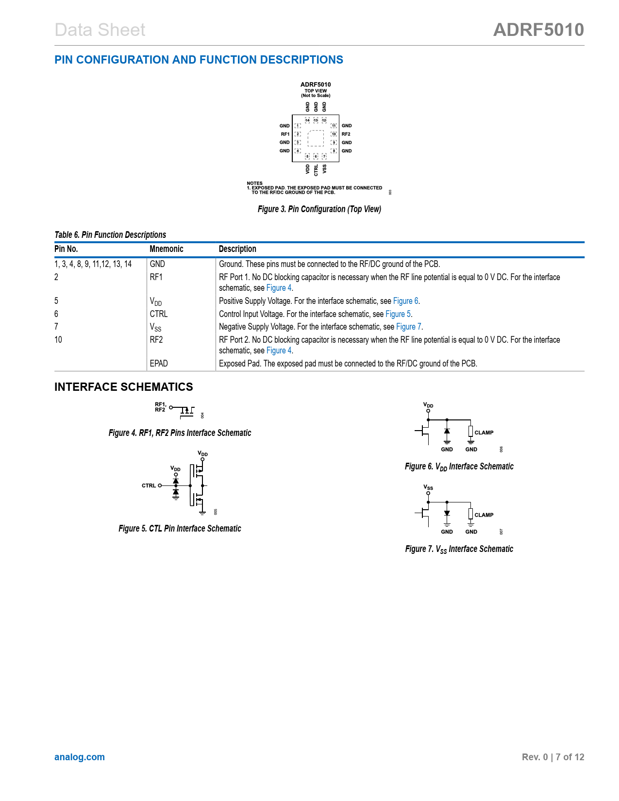

ADRF5010. PIN CONFIGURATION AND FUNCTION DESCRIPTIONS. Figure 3. Pin Configuration (Top View)
ADRF5010 PIN CONFIGURATION AND FUNCTION DESCRIPTIONS Figure 3 Pin Configuration (Top View)
link to page 7 link to page 7 link to page 7 link to page 7 link to page 7 Data Sheet
ADRF5010 PIN CONFIGURATION AND FUNCTION DESCRIPTIONS Figure 3. Pin Configuration (Top View) Table 6. Pin Function Descriptions Pin No. Mnemonic Description
1, 3, 4, 8, 9, 11,12, 13, 14 GND Ground. These pins must be connected to the RF/DC ground of the PCB. 2 RF1 RF Port 1. No DC blocking capacitor is necessary when the RF line potential is equal to 0 V DC. For the interface schematic, see Figure 4. 5 VDD Positive Supply Voltage. For the interface schematic, see Figure 6. 6 CTRL Control Input Voltage. For the interface schematic, see Figure 5. 7 VSS Negative Supply Voltage. For the interface schematic, see Figure 7. 10 RF2 RF Port 2. No DC blocking capacitor is necessary when the RF line potential is equal to 0 V DC. For the interface schematic, see Figure 4. EPAD Exposed Pad. The exposed pad must be connected to the RF/DC ground of the PCB.
INTERFACE SCHEMATICS Figure 4. RF1, RF2 Pins Interface Schematic Figure 6. VDD Interface Schematic Figure 5. CTL Pin Interface Schematic Figure 7. VSS Interface Schematic analog.com Rev. 0 | 7 of 12
