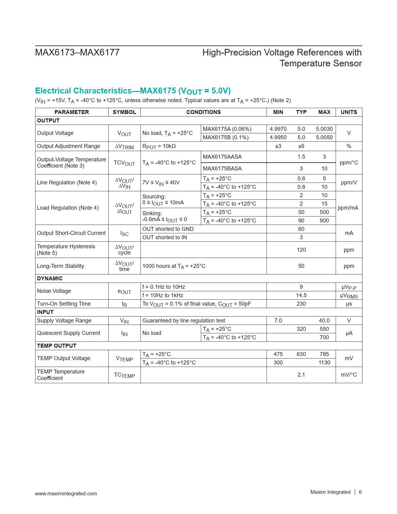

MAX6173–MAX6177 High-Precision Voltage References with Temperature Sensor
Electrical Characteristics—MAX6175 (VOUT = 5.0V)
(VIN = +15V, TA = -40°C to +125°C, unless otherwise noted. Typical values are at TA = +25°C.) (Note 2)
PARAMETER SYMBOL CONDITIONS MIN TYP MAX UNITS OUTPUT
MAX6175A (0.06%) 4.9970 5.0 5.0030 Output Voltage VOUT No load, TA = +25°C V MAX6175B (0.1%) 4.9950 5.0 5.0050 Output Adjustment Range DVTRIM RPOT = 10kΩ ±3 ±6 % Output-Voltage Temperature MAX6175AASA 1.5 3 Coefficient (Note 3) TCVOUT TA = -40°C to +125°C ppm/°C MAX6175BASA 3 10 T Line Regulation (Note 4) DVOUT/ A = +25°C 0.6 5 DV 7V ≤ V ppm/V IN IN ≤ 40V TA = -40°C to +125°C 0.8 10 Sourcing: TA = +25°C 2 10 0 ≤ IOUT ≤ 10mA T Load Regulation (Note 4) DVOUT/ A = -40°C to +125°C 2 15 DI ppm/mA OUT Sinking: TA = +25°C 50 500 -0.6mA ≤ IOUT ≤ 0 TA = -40°C to +125°C 90 900 OUT shorted to GND 60 Output Short-Circuit Current ISC mA OUT shorted to IN 3 Temperature Hysteresis DVOUT/ (Note 5) cycle 120 ppm Long-Term Stability DVOUT/ time 1000 hours at TA = +25°C 50 ppm
DYNAMIC
f = 0.1Hz to 10Hz 9 µV Noise Voltage e P-P OUT f = 10Hz to 1kHz 14.5 µVRMS Turn-On Settling Time tR To VOUT = 0.1% of final value, COUT = 50pF 230 µs
INPUT
Supply Voltage Range VIN Guaranteed by line regulation test 7.0 40.0 V T Quiescent Supply Current I A = +25°C 320 550 IN No load µA TA = -40°C to +125°C 700
TEMP OUTPUT
T TEMP Output Voltage V A = +25°C 475 630 785 TEMP mV TA = -40°C to +125°C 300 1130 TEMP Temperature Coefficient TCTEMP 2.1 mV/°C www.maximintegrated.com Maxim Integrated │ 6 Document Outline _GoBack
