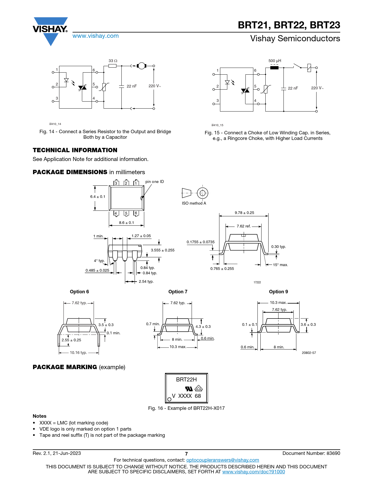

www.vishay.com Vishay Semiconductors 33 Ω 500 µH 1 6 1 6 2 5 22 nF 220 V~ 2 5 22 nF 220 V~ 3 4 3 4 iil410_14 iil410_15 Fig. 14 - Connect a Series Resistor to the Output and Bridge Fig. 15 - Connect a Choke of Low Winding Cap. in Series, Both by a Capacitor e.g., a Ringcore Choke, with Higher Load Currents

PACKAGE DIMENSIONS
in millimeters pin one ID 3 2 1 6.4 ± 0.1 ISO method A 4 5 6 9.78 ± 0.25 8.6 ± 0.1 7.62 ref. 1 min. 1.27 ± 0.05 0.1755 ± 0.0735 0.30 typ. 3.555 ± 0.255 4° typ. 15° max. 0.84 typ. 0.765 ± 0.255 0.485 ± 0.025 0.84 typ. 2.54 typ. 17222
Option 6 Option 7 Option 9
7.62 typ. 7.62 typ. 10.3 max. 7.62 typ. 0.7 min. 3.5 ± 0.3 4.3 ± 0.3 0.1 ± 0.1 3.6 ± 0.3 0.1 min. 2.55 ± 0.25 8 min. 0.6 min. 10.3 max. 0.6 min. 8 min. 10.16 typ. 20802-57
PACKAGE MARKING
(example) BRT22H V XXXX 68 Fig. 16 - Example of BRT22H-X017
Notes
• XXXX = LMC (lot marking code) • VDE logo is only marked on option 1 parts • Tape and reel suffix (T) is not part of the package marking Rev. 2.1, 21-Jun-2023
