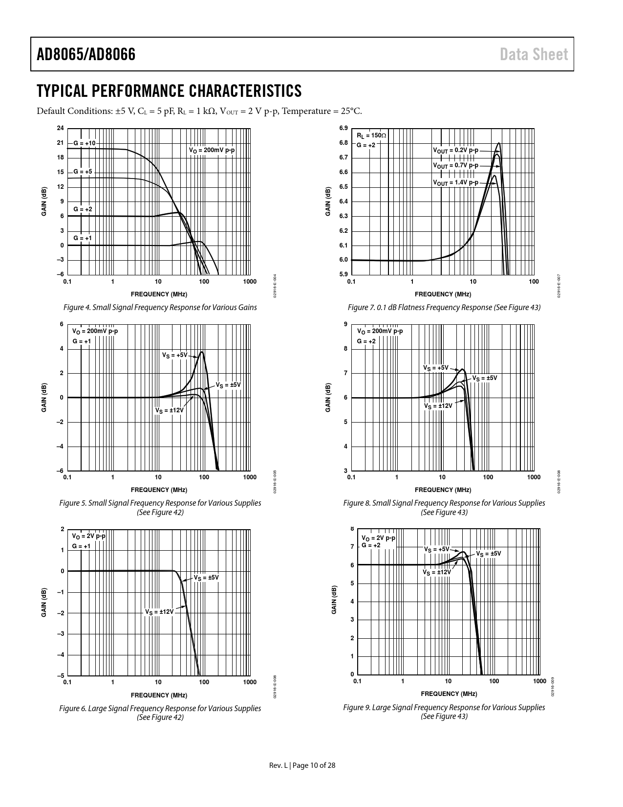

AD8065/AD8066 Data Sheet TYPICAL PERFORMANCE CHARACTERISTICS
Default Conditions: ±5 V, CL = 5 pF, RL = 1 kΩ, VOUT = 2 V p-p, Temperature = 25°C.
24 6.9 RL = 150
21 G = +10 6.8 G = +2 VO = 200mV p-p VOUT = 0.2V p-p 18 6.7 VOUT = 0.7V p-p 15 G = +5 6.6 V 12 6.5 OUT = 1.4V p-p 9 6.4 G = +2 GAIN (dB) 6 GAIN (dB) 6.3 3 6.2 G = +1 0 6.1 –3 6.0 –6 5.9 0.1 1 10 100 1000 0.1 1 10 100 FREQUENCY (MHz)
02916-E-004
FREQUENCY (MHz)
02916-E-007 Figure 4. Small Signal Frequency Response for Various Gains Figure 7. 0.1 dB Flatness Frequency Response (See Figure 43)
6 9 VO = 200mV p-p VO = 200mV p-p G = +1 G = +2 4 8 VS = +5V VS = +5V 2 7 VS = ±5V VS = ±5V 0 6 V GAIN (dB) V S = ±12V S = ±12V GAIN (dB) –2 5 –4 4 –6 3 0.1 1 10 100 1000 0.1 1 10 100 1000 FREQUENCY (MHz)
02916-E-005
FREQUENCY (MHz)
02916-E-008 Figure 5. Small Signal Frequency Response for Various Supplies Figure 8. Small Signal Frequency Response for Various Supplies (See Figure 42) (See Figure 43)
2 8 VO = 2V p-p VO = 2V p-p G = +1 7 G = +2 1 VS = +5V VS = ±5V 6 0 VS = ±12V VS = ±5V 5 –1 B) d N ( 4 AI –2 V GAIN (dB) S = ±12V G 3 –3 2 –4 1 –5 0 0.1 1 10 100 1000 0.1 1 10 100 1000
009
FREQUENCY (MHz) FREQUENCY (MHz)
02916- 02916-E-006 Figure 6. Large Signal Frequency Response for Various Supplies Figure 9. Large Signal Frequency Response for Various Supplies (See Figure 42) (See Figure 43) Rev. L | Page 10 of 28 Document Outline Features Applications Connection Diagrams General Description Table of Contents Revision History Specifications ±5 V Specifications ±12 V Specifications +5 V Absolute Maximum Ratings Maximum Power Dissipation Output Short Circuit ESD Caution Typical Performance Characteristics Test Circuits SOIC-8 Pinout Theory of Operation Closed-Loop Frequency Response Noninverting Closed-Loop Frequency Response Inverting Closed-Loop Frequency Response Wideband Operation Input Protection Thermal Considerations Input and Output Overload Behavior Layout, Grounding, and Bypassing Considerations Power Supply Bypassing Grounding Leakage Currents Input Capacitance Output Capacitance Input-to-Output Coupling Wideband Photodiode Preamp High Speed JFET Input Instrumentation Amplifier Video Buffer Outline Dimensions Ordering Guide Automotive Products
