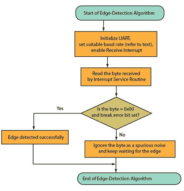

This way, if a spurious noise glitch interrupts the controller, the input will return to a logic high before the baud-rate clock finishes reading a byte (Fig. 1). The Interrupt Service Routine will now detect a “non-zero byte” without any error. The application routine (Fig. 2) can recognize this as a spurious glitch and ignore it.
Figure 2. The flow-chart shows how UART-based edge detection works. Note that if b0 through b7 is zero and the break error bit is set (logic zero), the edge will be detected.
