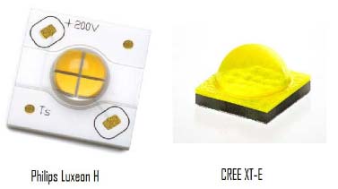

High voltage LEDs are becoming more popular and are now available from multiple LED manufacturers such as CREE and Philips-Lumileds. These package LEDs may have typical forward voltages ranging from 24 to >200 V.

Example High Voltage LED Products
