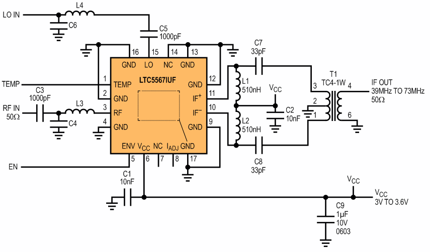

Figure 1 shows an impedance match design with the LTC5567.
High Input IP3 Mixer Enables Robust VHF Receivers
Figure 1. VHF Mixer Design.

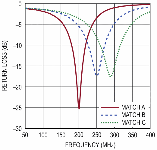

Table 1 shows the design values extending input port match below 300 MHz, down to 150 MHz, results are also provided.
Table 1. VHF Impedance Match Design Values.
MATCH
RF INPUT
L3
C4
LO INPUT
L4
C6
A
150 MHz
8.2 nH
56 pF
200 MHz
3.9 nH
47 pF
B
200 MHz
6.8 nH
39 pF
250 MHz
2.7 nH
33 pF
C
250 MHz
3.9 nH
27 pF
300 MHz
1.5 nH
27 pF

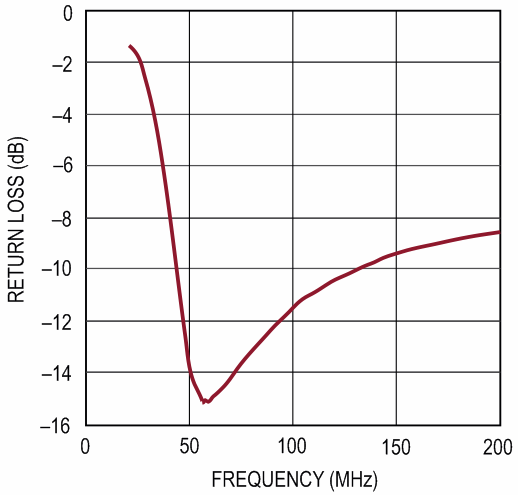

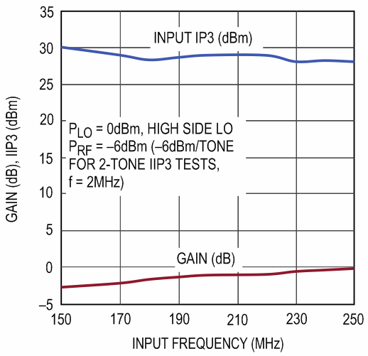

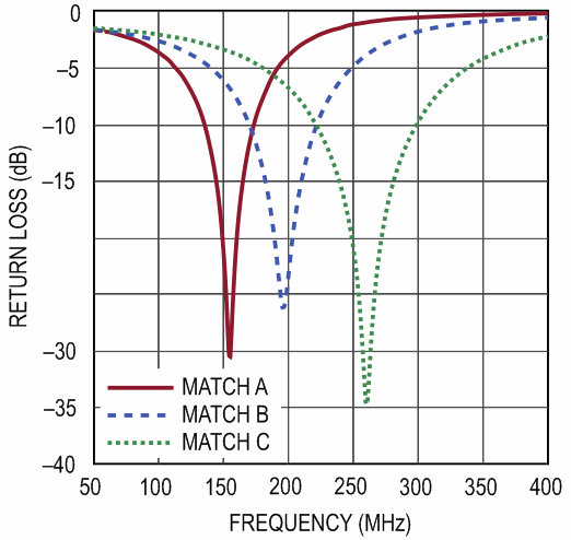

Figure 2 shows the LTC5567 mixer gain and input IP3 versus input frequency. The mixer linearity performance improves as input frequency approaches 150 MHz. Input, LO and output port return loss measurements are shown in Figures 3, 4 and 5, respectively. The overall performance is maintained in the VHF range compared to higher input frequencies. As a result, the high IP3 and conversion gain yields maximum dynamic range when used in radio designs. Higher dynamic range minimizes adjacent channel interference, improving selectivity. Operating the LTC5567 below 150 MHz input is possible with reduced conversion gain, but not recommended, due to the internal transformer becoming lossy.
High Input IP3 Mixer Enables Robust VHF Receivers High Input IP3 Mixer Enables Robust VHF Receivers
Figure 2. Mixer IIP3 and Gain Performance

Figure 3. RF Input Return Loss.

Figure 4. LO Input Return Loss.
Figure 5. IF Output Return Loss.
