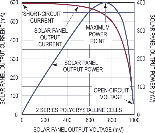

Although solar cells or solar panels are rated by power output, a panel’s available power is hardly constant. Its output power depends heavily on illumination, temperature and on the load current drawn from the panel. To illustrate this, Figure 1 shows the V-I characteristic of a 2-cell solar panel at a constant illumination. The I-vs-V curve features a relatively constant-current characteristic from shortcircuit (at the far left) to around 550 mA load current, at which point it bends to a constant-voltage characteristic at lower currents, approaching maximum voltage at open circuit (far right). The panel’s power output curve shows a clear peak in power output around 750 mV/530 mA, at the knee of the I-vs-V curve. If the load current increases beyond the power peak, the power curve quickly drops to zero (far left). Likewise, light loads push power toward zero (far right), but this tends to be less of an issue.
| Figure 1. | Solar Panel Output Voltage, Current and Power. | |
Of course, panel illumination affects available power – less light means lower power output; more light, more power. Although illumination directly affects the value of peak power output, it does not do much to affect the peak’s location on the voltage scale. That is, regardless of illumination, the panel output voltage at which peak power occurs remains relatively constant. Thus, it makes sense to moderate the output current so that the solar panel voltage remains at or above this peak power voltage, in this case 750 mV. Doing so is called maximum power point control (MPPC).

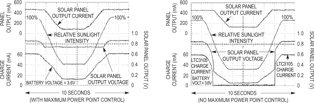

Figure 2 shows the effects of varying sunlight on the charge current, with maximum power point control and without. The simulated sunlight is varied from 100% down to approximately 20%, then back up to 100%. Note that as the sunlight intensity drops about 20%, the solar panel’s output voltage and current also drop, but the LTC3105 maximum power point control prevents the panel’s output voltage from dropping below the programmed 750 mV. It accomplishes this by reducing the LTC3105 output charge current to prevent the solar panel from collapsing to near zero volts, as is shown in the plot on the right side of Figure 2. Without power point control, a small reduction in sunlight can completely stop charge current from flowing.
| Figure 2. | Changing Sunlight Intensity Effects on Charge Current. | |

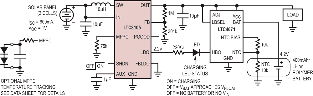

Solar-Powered Li-Ion Battery Charger
Figure 3 shows a compact solar-powered battery charger using a LTC3105 as a boost converter and a LTC4071 as a Li-Ion shunt charger. A 2-cell 400 mW solar panel provides the input power to the LTC3105 to produce over 60 mA of charge current in full sunlight. Maximum power point control prevents the solar panel voltage from dropping below the 750 mV maximum power point, as shown in Figure 1. The converter’s output voltage is programmed for 4.35 V, slightly above the 4.2 V float voltage of the Li-Ion battery. The LTC4071 shunt charger limits the voltage across the battery to 4.2 V. Grounding the FBLDO pin programs the low dropout regulator to 2.2 V, which powers the “charging” LED. This LED is on when charging and off when the battery voltage is within 40 mV of the float voltage, indicating near full charge. An NTC thermistor senses battery temperature and lowers the LTC4071 float voltage at high ambient temperatures for increased battery safety. To prevent battery damage from overdischarge, the low battery disconnect feature disconnects the battery from the load if the battery drops below 2.7 V.
| Figure 3. | 2-Cell Solar Panel Li-Ion Battery Charger. | |

Although the circuit described here produces only a few hundred milliwatts, it can provide enough power to keep a 400 mA×hr Li-Ion battery fully charged under most weather conditions. The low input voltage, combined with input power control, makes the LTC3105 ideal for low power solar applications. In addition, the LTC4071 shunt charging system complements the LTC3105 by providing the precision float voltage, charge status and temperature safety features to assure long battery life in outdoor environments.
