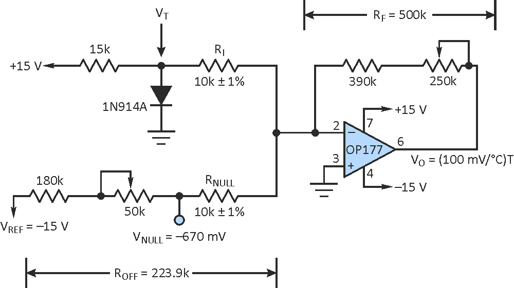

Figure 1. Several simple equations make it easy to design this signal-conditioning circuit for
interfacing a temperature sensor with a microcontroller.

Equation 3 indicates that the signal-conditioning circuit must amplify VT by a gain of –50 and offset this voltage by 33.5 V. The circuit depicted in the Figure 1 can implement this design equation because its performance equation is:
  (4)
Comparing the design equation (Equation 3) and performance equation (Equation 4) terms simplifies component selection. The signal path of the inverting adder circuit is set by making the gain terms’ resistance ratio,
and the offset term,
set to the needed 33.5 V.
Making RNULL = RI enables you to calibrate the zero point of the circuit at any temperature. First, measure VNULL and adjust the 50-kW ROFF potentiometer for a voltage of –670 mV, which is the sensor’s output at 0 °C. Then, with the sensor stable at a known temperature (for example, 24 °C), adjust the –50-kW RF potentiometer to make the output voltage of the operational amplifier conform to the system equation:
VO (@ 24 °C) = (100 mV/°C)×(24 °C) = 2.40 V.
