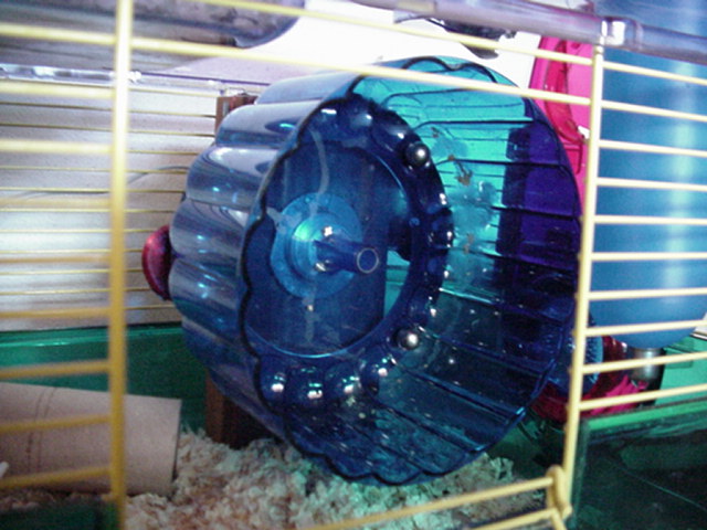

So, we chose to scratch-build a tiny low-RPM alternator for the hamster wheel. The first issue we noticed is that the wheel that came with the cage was noisy when Skippy ran on it. VERY noisy! That meant that some of Skippy's energy was being converted to sound by mechanical vibration--and we want all of his energy to go into power production! So the first thing we did was modify the wheel with a new ball bearing. We simply used one of our inexpensive, surplus DC brushless motors. Although the design of the motor itself is exactly like a permanent magnet (PM) alternator, these motors can't produce enough power to even light an LED at low RPMs. We used it simply because it was a cheap source for a really nice little ball bearing, and was easy to mount the wheel to. You could use any free-spinning bearing that's available--off an old skateboard, rollerskate, anything that spins freely and you can mount the wheel to.
surplus brushless DC motor
Surplus brushless DC motor used for the ball bearing inside and easy mounting

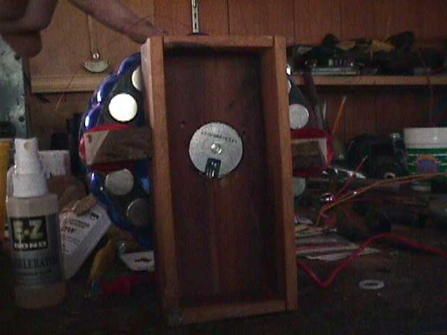

To mount the wheel to the motor, we simply centered it on the wheel and marked 3 holes from the top of the hub for drilling. The motor hub has 6 holes--3 are tapped to a weird little SAE 2/56 thread, the other 3 are blank. We used a simple 4/40 tap to thread these smooth holes to fit 4/40 machine screws, and mounted the wheel to the motor hub with these. The motor was then mounted to a thin piece of wood. The entire wheel is free-standing on this wooden bracket -- it does not have to mount to the side of the rodent cage.

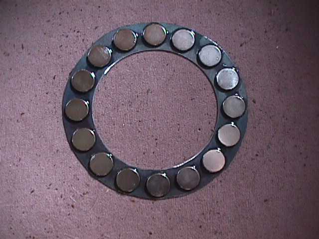

We cut out a ring of approx. 16 gauge steel to fit the wheel. You could easily use 2 coffee can lids stacked and cut out for this-- you could use a drill and tin snips for this. We used a hole saw for the inner circle and a bandsaw for the outer. Be careful, when the steel is first cut the edges will be very sharp! Grind them down with a wheel or file so they are safe for both you and your rodent. This steel ring behind the magnets forms a more complete magnetic circuit so there's more flux passing through the stator coils. It also makes it much easier to mount and evenly space the magnets, since they stick to it.
magnets on steel ring
Magnets mounted on steel ring
We chose the magnet size with the limited amount of power a hamster can produce in mind. They are our Item #30, 3/4 inch diameter by 1/8 inch thick Grade N-35 Neodymium-Iron-Boron magnets. Very powerful, but not too heavy. You can make up for lots of design and mechanical tolerance problems by using very strong magnets in a homemade alternator! If you use weaker magnets, your power output will be significantly reduced. We used 14 magnets because it was the largest EVEN number of magnets we could space around the ring, so this may vary depending on the size of your rodent's wheel. You must use an even number of magnets. We spaced them evenly using playing cards...by trial and error we found the right number of cards to use as a shim between each magnet. It's important to get them spaced evenly. The magnets also must be placed with the North and South poles alternating on each magnet. And the edges of the magnets should be aligned in a perfect circle, too. Read on for magnet mounting details.
Compared to the giant, finger-breaking magnets we used in our 10 foot wind turbines, these little magnets are pretty safe and easy to work with. They are, however, powerful enough to pinch skin and give you a blood blister, so handle them carefully and keep out of reach of young children. Parental guidance is needed for older kids too. Please read our Magnet Safety Warnings before starting the project!
First, place one magnet on the steel ring and center it between the inner and outer edges of the ring. Tack it down with a drop of cyanoacrylate glue (Superglue®) applied around the edges--be sure to use thin viscosity glue, so it will wick underneath the magnets and set up. It also helps to have glue accelerator around--one spritz of this and the glue sets up instantly (keep your fingers out of the way!). Now each magnet must be placed with the opposite polarity of it's neighbors facing out. To get this right, carefully take each new magnet off of the stack, and carefully hold it up to the next magnet mounted on the ring. If it repels, hold the magnet exactly as it is oriented and gently snap it to the ring. Use this test for placing each magnet, and check it when you are done....the magnets should alternately repel and attract the magnet in your hand as you go around the ring testing. Remember, you must always use an even number of magnets. After they are all placed, use playing cards to space them so they are aligned evenly around the circle. And make sure they are aligned in a perfect circle radially too -- check the inner and outer diameters of the circle of magnets and slide them around to get perfect alignment both ways. When everything is good and you've checked to be sure the magnets alternate in polarity, tack all of them down with drops of thin superglue appied around the edges of the magnets.
To make things simple, we simply centered the magnet disc on the back of the plastic hamster wheel, and held it in place with 4 more strong magnets stuck to the inside of the wheel! This makes it easy to remove, but still holds it tightly on there. You could also use glue if needed. Remember also in designing your mount -- the magnetic field from the magnet disc should be away from metal cage bars or other metal parts.....it will be attracted to these metal parts and will be slowed down significantly.....you'll be wasting lots of hamster power. And use caution handling the disc -- it will be powerfully attracted to ferrous metal or other magnets.

At this point you can mount the first coil. We simple glued it to a small block of wood and glued this to the frame. Get the coil as close to the rotating magnet ring as possible without it touching. We ended up with a big airgap here due to the wobbly motion of the wheel....about 1/8 inch. But the big magnets make up for this tolerance flaw. You should get an AC voltage reading now from the mounted coil when you spin the wheel. We could get more power out of the coil by mounting laminates or another magnet rotor behind them, like we do when building wind turbine alternators. But we decided that Skippy probably wouldn't care either way, and one side of the magnetic circuit open made for much easier construction.
closeup of mounted coil
Closeup of mounted coil.

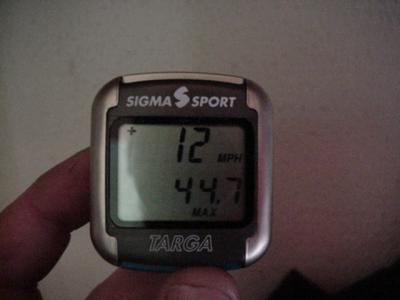

Next, we want to install the data acquisition computer for the system. We used an inexpensive bicycle computer, available at any bike store. The trigger is simply a cylidrical NdFeB magnet, and comes included with the bike computer. We disassembled the sensor and trigger to show how they are constructed. You don't have to do this unless you want to. The sensor is simply a reed switch connected to the computer -- I had already used the sensor from this computer for another project, so I just got another reed switch and made a new sensor, shown below. Again, you don't need to do this unless you want to.
magnet trigger glued to outside radius of wheel
reed switch
Reed switch trigger
We simply taped the reed switch sensor to a small piece of wood and glued it to the frame. The magnet must pass within 1/8 to 1/4 inch of the sensor to trigger it. Now you need to tell the computer the circumference of your rodent's wheel, in millimeters. There will be a special button for setting the wheel size, consult the owner's manual of the bike computer. Skippy's wheel turned out to be 540 millimeters in circumference. After the computer is set, spinning the wheel should show you a miles per hour reading! Skippy does from 2-3 mph at normal speed, and slightly faster when DanF's cats are leering at him through the cage walls. The computer will also keep track of maximum speed, average speed, time spent on the wheel, and total miles run for you. We just got Skippy's system up and running, so we don't have any data yet for average hamster-miles per night yet.

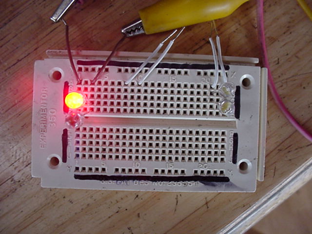

Lights
LEDs lit by Hamster
