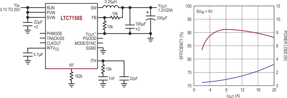

Schematic and Efficiency of the Buck Converter: 12 VIN to 1.2 VOUT at 20 A
Figure 1. Schematic and Efficiency of the Buck Converter: 12 VIN to 1.2 VOUT at 20 A
Figure 1 shows a 1.2 V output at 20 A solution for SoC and CPU power using the LTC7150S switching at 1 MHz. This circuit can be easily modified to accommodate other output combinations, including 3.3 V, 1.8 V, 1.1 V and 0.6 V to take advantage of the wide input range of the LTC7150S. The LTC7150S has the output current capability to act as a first stage 5 V supply, which can be followed by a number of downstream second-stage switching or LDO regulators at various outputs.

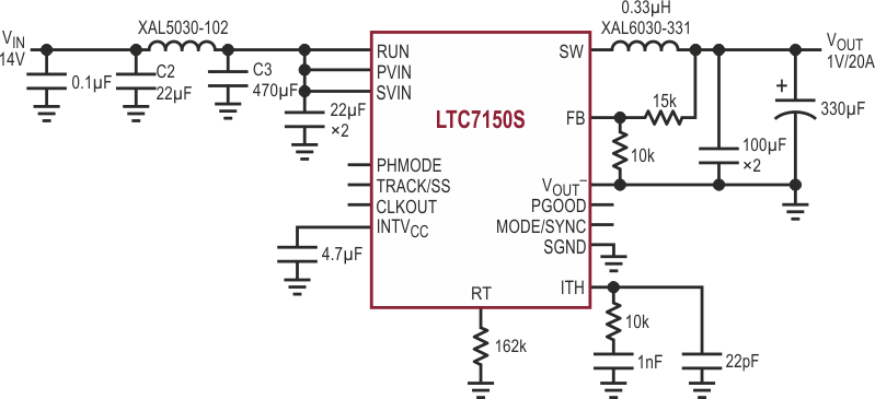

VIN = 14 V, VOUT = 1 V, 20 A. fSW = 400 kHz
Figure 2a. VIN = 14 V, VOUT = 1 V, 20 A. fSW = 400 kHz

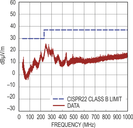

Radiated EMI Performance of Figure 2
Figure 2b. Radiated EMI Performance of Figure 2
Analog Devices’ proprietary Silent Switcher 2 architecture self-cancels EMI via integrated hot loop capacitors, minimizing noisy antenna size. This, combined with integrated MOSFETs, significantly reduces switching node ringing and associated energy stored in the hot loop, even with very fast switching edges. The result is exceptional EMI performance while minimizing the AC switching losses. Silent Switcher 2 is incorporated in the LTC7150S to minimize EMI and deliver high efficiency, greatly simplifying EMI filter design and layout, ideal for noise-sensitive environments. LTC7150S passes the CISP R22 /32 conducted and radiated EMI peak limits with only a simple EMI filter in front. Figure 2b shows the radiated EMI CISPR22 test result.

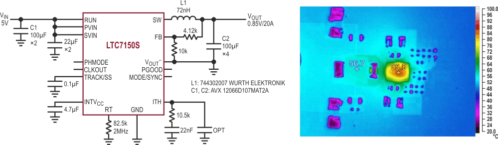

Integrated MOSFETs, integrated hot-loop decoupling capacitors, built-in compensation circuit — all take the design complexity out of the system and minimize total solution size with circuitry simplicity and Silent Switcher architecture. Thanks to high-performance power conversion, LTC7150S delivers high current without the need for additional heat sinks or airflow. Unlike most solutions, both low EMI and high efficiency can be achieved at high frequency operation, ensuring small passive component size. Figure 3 shows a 2 MHz solution, which uses a small 72 nH inductor and all ceramic capacitors in a very low-profile solution for FPGA and μP applications.
LTC7150S Schematic and Thermal Image for 5 V Input to 0.85 V /20 A Output  with fSW = 2 MHz.
Figure 3. LTC7150S Schematic and Thermal Image for 5 V Input to 0.85 V /20 A Output  with fSW = 2 MHz.
