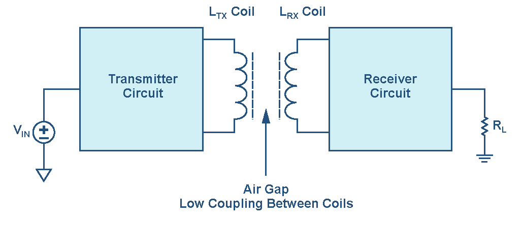

A wireless power transfer (WPT) system is composed of two parts separated by an air gap: transmitter (Tx) circuitry with a transmit coil, and receiver (Rx) circuitry with a receive coil (see Figure 1). Much like in a typical transformer system, ac generated in the transmit coil induces ac in the receive coil via a magnetic field. However, unlike in a typical transformer system, the coupling between the primary (transmitter) and secondary (receiver) is typically very low. This is due to the nonmagnetic material (air) gap.
Wireless power transfer system.
Figure 1. Wireless power transfer system.

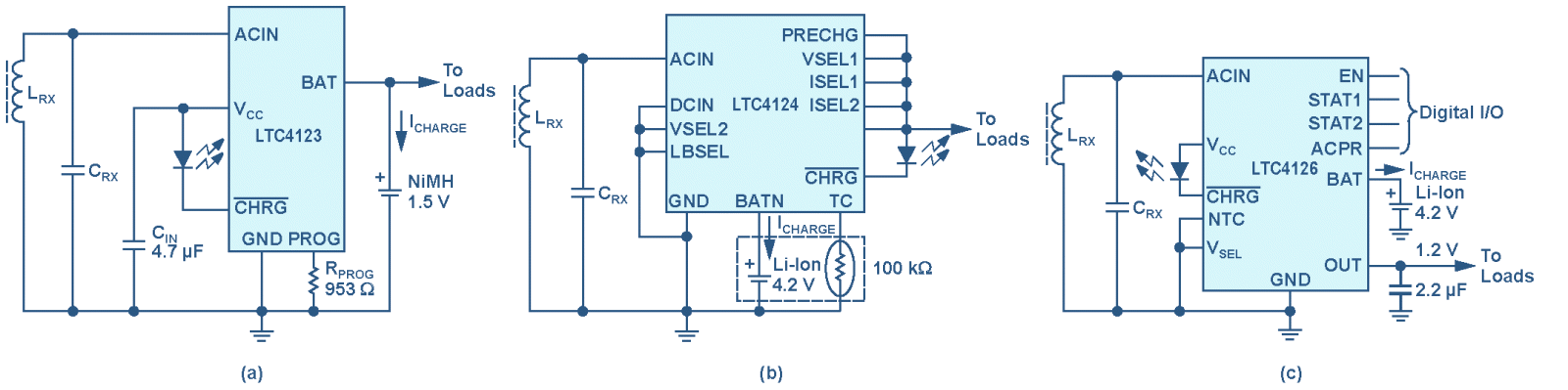

Most wireless power transfer applications in use today are configured as wireless battery chargers. A rechargeable battery resides on the receiver side and is charged wirelessly whenever in the presence of a transmitter. After charging is complete, and when the battery is subsequently taken off of the charger, the rechargeable battery then powers the end application. Downstream loads can connect either directly to the battery, indirectly to the battery through a PowerPath™ ideal diode, or to the output of a battery-powered regulator integrated into the charger IC. In all three scenarios (see Figure 2), the end application can run either on or off the charger.
Wireless Rx battery chargers with downstream loads connected to a) a battery, b) a PowerPath ideal diode, and c) a regulator output.
Figure 2. Wireless Rx battery chargers with downstream loads connected to a) a battery, b) a PowerPath

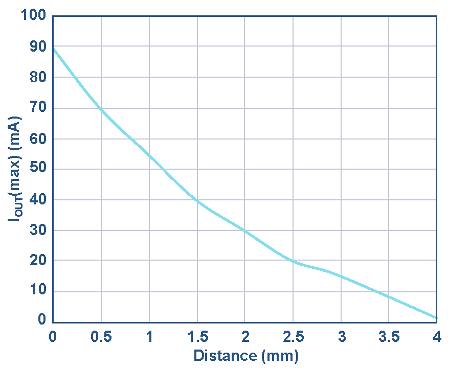

Test results: For the application shown in Figure 3 with a 2 mm air gap, the measured max deliverable output current at 3.3 V was 30 mA and the measured no load VIN voltage was 9.1 V. For a near-zero air gap, the max deliverable output current increased to approximately 90 mA while the no load VIN voltage increased to only 16.2 V, well below the input protective shunt voltage (see Figure 4).
Max deliverable output current at 3.3 V for various distances.
Figure 4. Max deliverable output current at 3.3 V for various distances.
