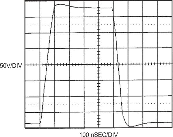

The circuit has a clean square-wave response with minimal over-shoot and no ringing.
Figure 2. The circuit has a clean square-wave response with minimal
You should mount all the power transistors in individual finned heat sinks with an overhead 3-in. fan for cooling. The pc-board layout is not critical and needs no ground plane. However, you must use single-point grounding to minimize ringing. For the component values shown, the circuit is very stable and needs no compensation capacitors. Figure 2 shows a large-signal response for a ±9 V, 1-MHz square-wave input. This circuit has a fixed gain of 20. For higher gains, you can increase the values of R6 and R7. For lower values, it is better to insert an attenuator at the input, because smaller values of R6 and R7 may result in excessive dissipation. Do not change the value of R8, because it is optimized for speed. Be cautious when measuring and using this circuit, because it harbors lethal voltages.
