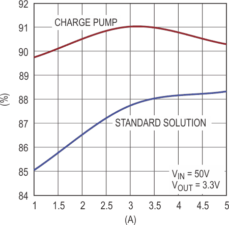

The efficiency of high input voltage DC/DC controllers can be significantly improved by using the controller’s output voltage to power the IC, instead of allowing the internal LDO to produce the bias voltage. For input voltages above 30 V, efficiency improvements of 2% to 3% are realized when a voltage doubler circuit is used for a 3.3 V at 5 A output (see Figure 4). Similar efficiency improvements are shown for a 1.8 V at 7 A converter with a multivibrator-based circuit.
LTC3890/LTC3891 efficiency improvement.
Figure 4. LTC3890/LTC3891 efficiency improvement.
