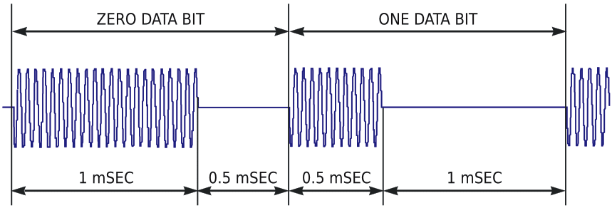

By decoding the commands sent by a direct-broadcast satellite receiver that uses the DISEqC (digital-satellite-equipment-control) protocol, you can troubleshoot the commands or simply listen in. Eutelsat Corp offers the DISEqC protocol. The technique uses only the coaxial cable between the receiver and the dish to send commands for actions such as changing the low-noise-block frequency range or switching between dishes for multisatellite reception. The DISEqC protocol specifies a bit time of 1.5 msec and bit values as shown in Figure 1, the timing diagram of bit modulation on the coaxial cable. The signal's ac portion is a 22-kHz burst whose amplitude ranges from 300 to 600 mV. A voltage-doubler circuit detects the 22-kHz portion, producing a pulse stream in which constant-voltage pulses having amplitudes of 0.6 to 1.2 V replace the 22-kHz bursts.
The DISEqC protocol specifies a bit time of 1.5 msec and these bit values.
Figure 1. The DISEqC protocol specifies a bit time of 1.5 msec and these bit values.
