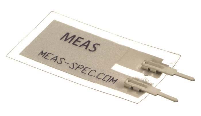

The figure shows a practical application circuit. For the prototype, the piezo film sensor, X1, was a Measurement Specialties LDTM-028K. This device already has a small weight attached at one end, and more mass was added to increase sensitivity.
The piezo device used in the accelerometer has a small weight attached to sense acceleration. More mass was added to increase sensitivity.

Mount X1 on a circuit board so the weight is hanging below the board and the sensor can flex in the direction of the acceleration to be measured. Adjust R1 downward to increase sensitivity. Adjust C3 and C4 to affect the low-pass filters’ time constants.
The sensor without additional weight The sensor with a small weight attached
Measurement Specialties - LDT0-028K Measurement Specialties - LDTM-028K
LDT0-028K LDTM-028K
