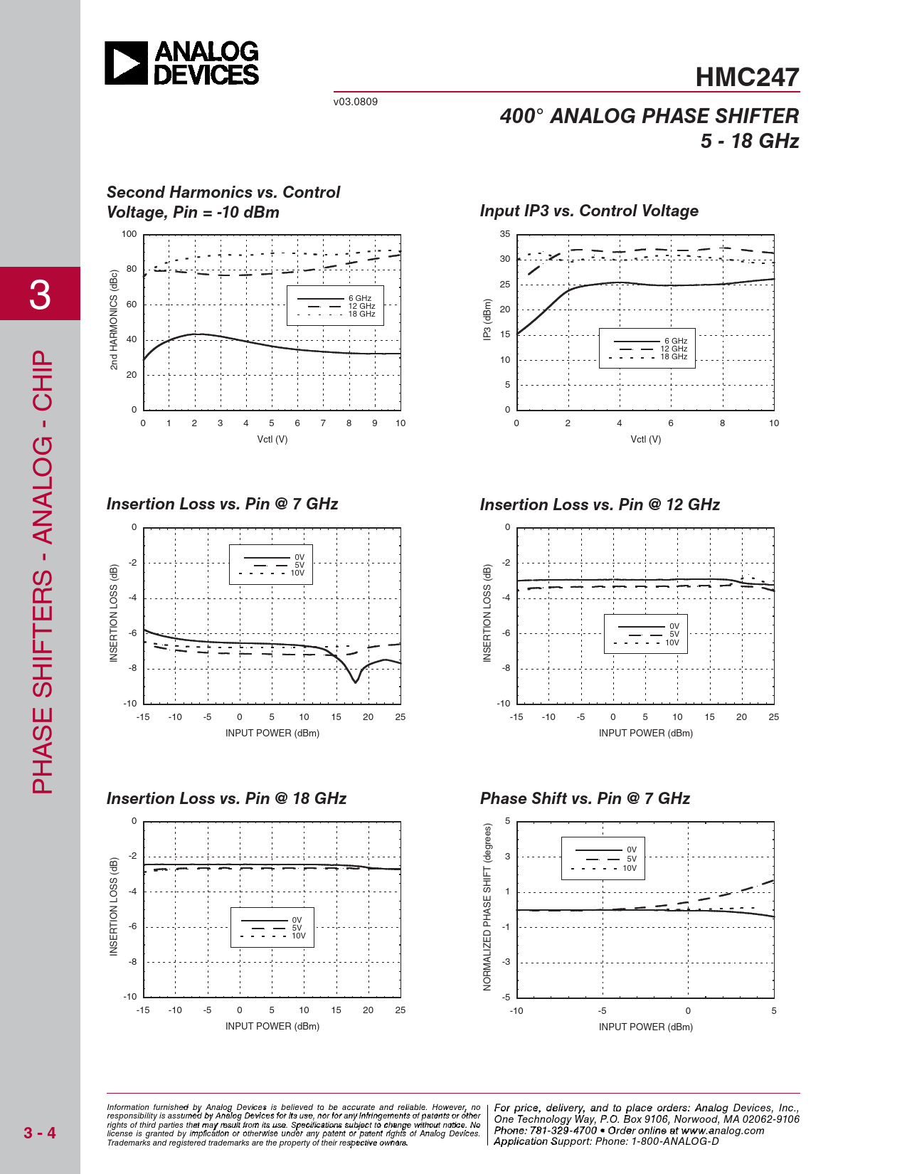

HMC247. 400° ANALOG PHASE SHIFTER. 5 - 18 GHz. Second Harmonics vs. Control Voltage, Pin = -10 dBm
HMC247 400° ANALOG PHASE SHIFTER 5 - 18 GHz Second Harmonics vs Control Voltage, Pin = -10 dBm
HMC247
v03.0809
400° ANALOG PHASE SHIFTER 5 - 18 GHz Second Harmonics vs. Control Voltage, Pin = -10 dBm Input IP3 vs. Control Voltage
100 35 30 80 3 25 6 GHz 60 12 GHz 20 18 GHz 15 40 IP3 (dBm) 6 GHz 12 GHz IP 10 18 GHz 2nd HARMONICS (dBc) H 20 5 0 0 0 1 2 3 4 5 6 7 8 9 10 0 2 4 6 8 10 Vctl (V) Vctl (V) OG - C L A
Insertion Loss vs. Pin @ 7 GHz Insertion Loss vs. Pin @ 12 GHz
N 0 0 0V -2 5V -2 S - A 10V R -4 -4 E T 0V -6 -6 5V 10V IF INSERTION LOSS (dB) INSERTION LOSS (dB) H -8 -8 -10 -10 E S -15 -10 -5 0 5 10 15 20 25 -15 -10 -5 0 5 10 15 20 25 S INPUT POWER (dBm) INPUT POWER (dBm) A H P
Insertion Loss vs. Pin @ 18 GHz Phase Shift vs. Pin @ 7 GHz
0 5 0V -2 3 5V 10V -4 1 0V -6 5V -1 10V INSERTION LOSS (dB) -8 -3 NORMALIZED PHASE SHIFT (degrees) -10 -5 -15 -10 -5 0 5 10 15 20 25 -10 -5 0 5 INPUT POWER (dBm) INPUT POWER (dBm) Information furnish F e o d r pri by An ce, de alog Devic leis vie s rby eli, a eve nd to pla d to be accur ce o ate an r d der relia s ble , pl . Ho ease co wever, no For price, delivery, and to place orders: Analog Devices, Inc., responsibility is assumed by Analog Devices for its use, nor for any infringements of patents or other ntact Hittite Microwave Corporation: One Technology Way, P.O. Box 9106, Norwood, MA 02062-9106 rights of third parties that may result from its use. Specifications subject to change without notice. No
