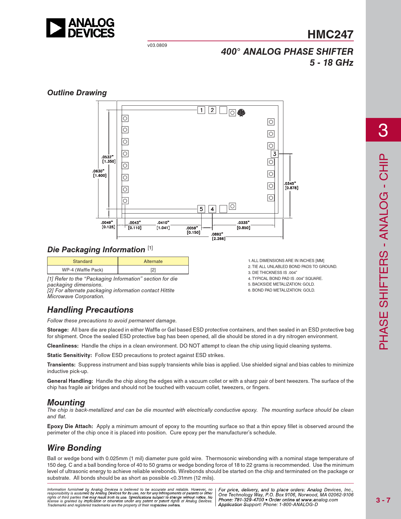

400° ANALOG PHASE SHIFTER 5 - 18 GHz Outline Drawing
3 IP H OG - C L A N
Die Packaging Information
[1] S - A Standard Alternate 1. ALL DIMENSIONS ARE IN INCHES [MM] 2. TIE ALL UNLABLED BOND PADS TO GROUND. R WP-4 (Waffle Pack) [2] 3. DIE THICKNESS IS .004” E [1] Refer to the “Packaging Information” section for die 4. TYPICAL BOND PAD IS .004” SQUARE. T packaging dimensions. 5. BACKSIDE METALIZATION: GOLD. [2] For alternate packaging information contact Hittite 6. BOND PAD METALIZATION: GOLD. IF Microwave Corporation. H
