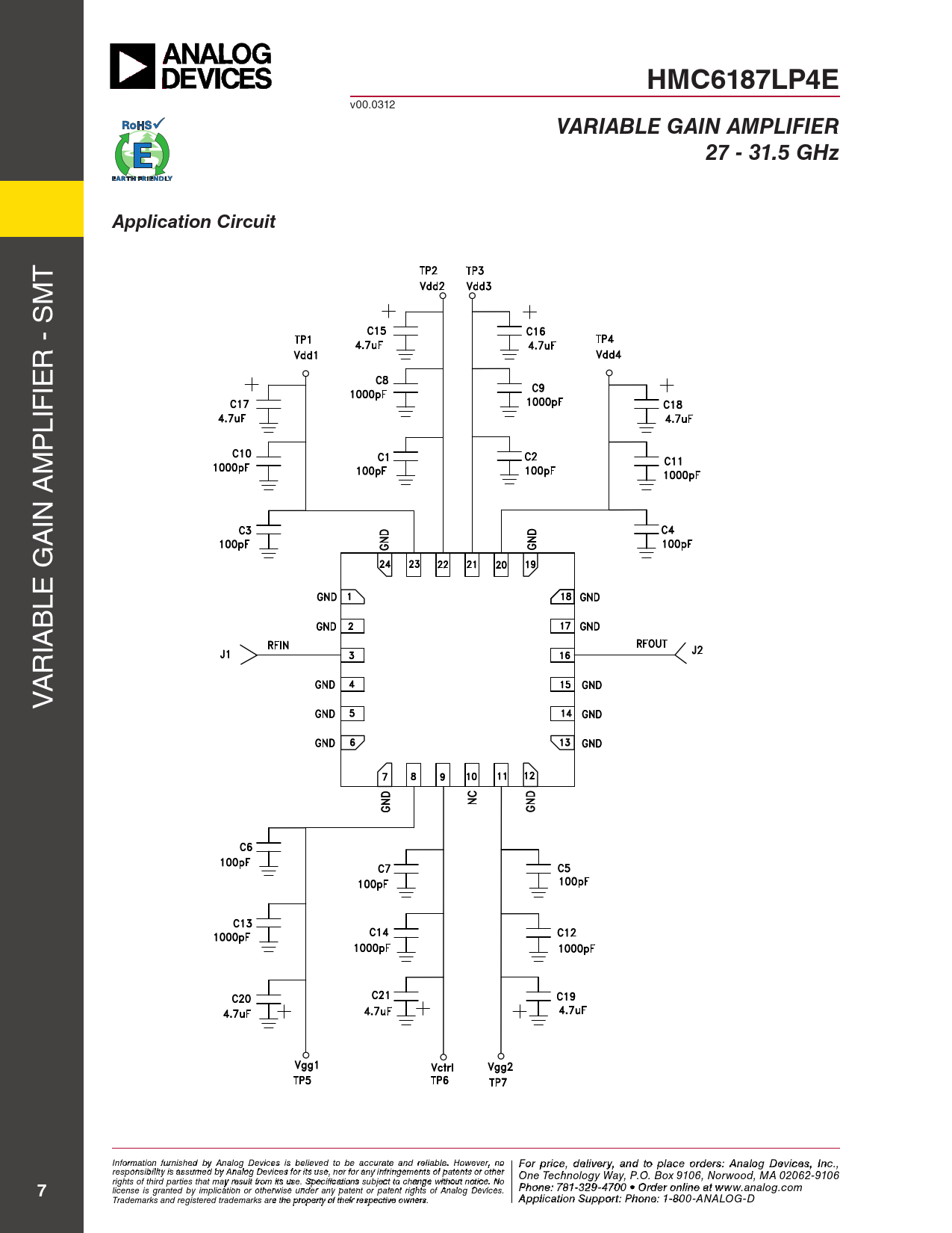

HMC6187LP4E. VARIABLE GAIN AMPLIFIER. 27 - 31.5 GHz. Application Circuit
HMC6187LP4E VARIABLE GAIN AMPLIFIER 27 - 31.5 GHz Application Circuit
HMC6187LP4E
v00.0312
