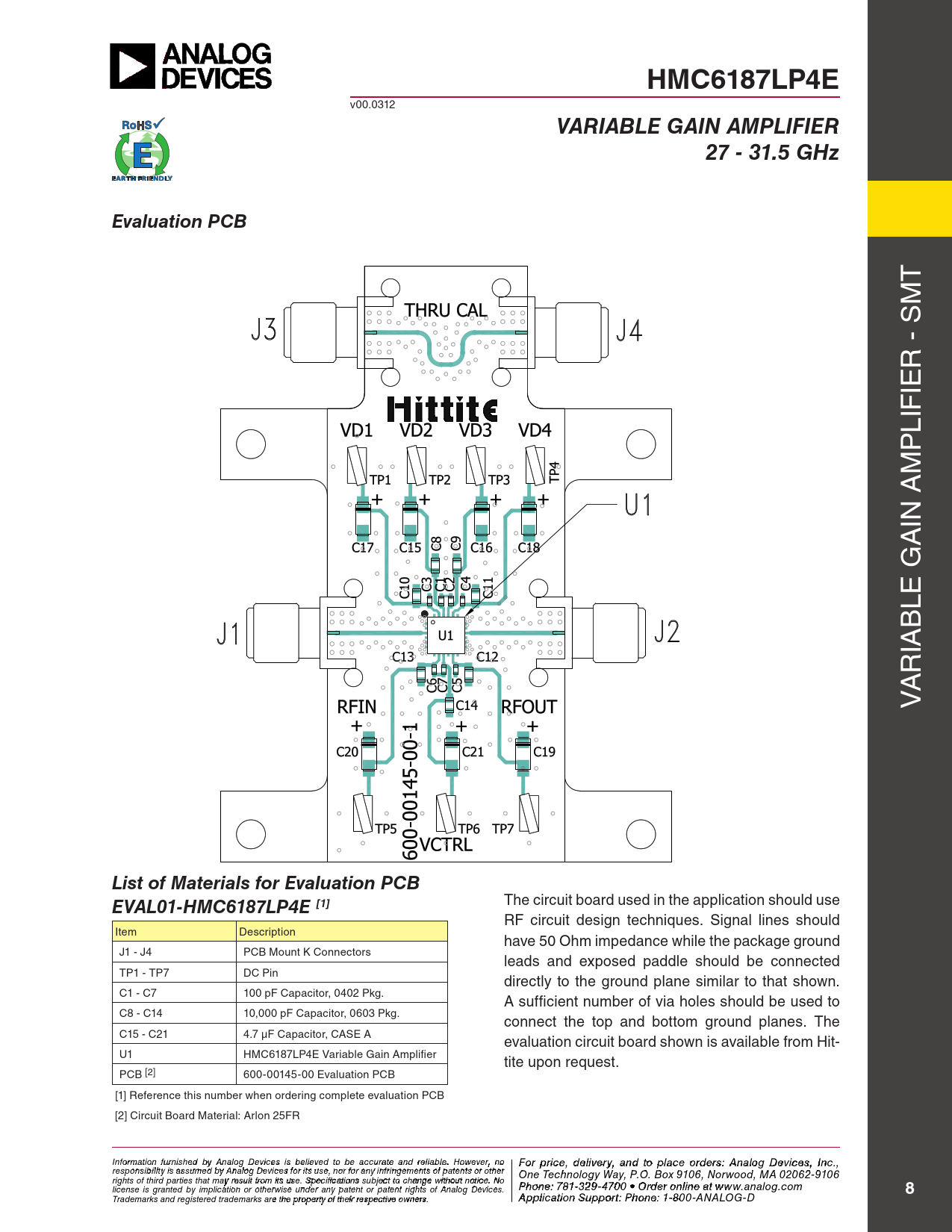

List of Materials for Evaluation PCB
The circuit board used in the application should use
EVAL01-HMC6187LP4E [1]
rf circuit design techniques. Signal lines should item Description have 50 Ohm impedance while the package ground J1 - J4 PCB Mount K Connectors leads and exposed paddle should be connected Tp1 - Tp7 DC pin directly to the ground plane similar to that shown. C1 - C7 100 pf Capacitor, 0402 pkg. a sufficient number of via holes should be used to C8 - C14 10,000 pf Capacitor, 0603 pkg. connect the top and bottom ground planes. The C15 - C21 4.7 µf Capacitor, CaSe a evaluation circuit board shown is available from Hit- U1 HmC6187lp4e Variable Gain amplifier tite upon request. pCb [2] 600-00145-00 evaluation pCb [1] reference this number when ordering complete evaluation pCb [2] Circuit board material: arlon 25fr Inf F or o m r p atio r n ifc ur e n , d ishe e d lbiv y e A r n y a alog n D d t evic o p es is la beclie o eved rd to ebre sa: H ccur iattti e tae M nd re ilicarbloew . H a o ve C wever, o n rp o For price, delivery, and to place orders: Analog Devices, Inc., responsibility is assumed by Analog Devices for its use, nor for any infringements of patents or other oration, 2 Elizabeth Drive, Chelmsford, MA 01824 One Technology Way, P.O. Box 9106, Norwood, MA 02062-9106 Phone: 978-250-3343 Fax: 978-250-3373 O rights of third parties that may result from its use. Specifications subject to change without notice. No P rd ho e ne r O : 7 n 81- -3li 2n 9 e a -47 t w 0 w 0 • O w rd .h e it r o tniltie n .c e ao t m license is granted by implication or otherwise under any patent or patent rights of Analog Devices. www.analog.com
