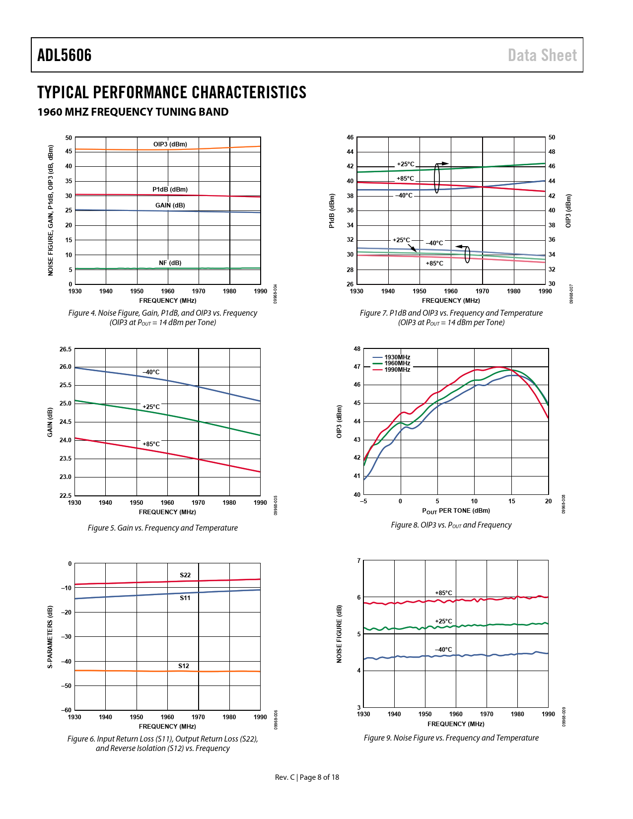

ADL5606. Data Sheet. TYPICAL PERFORMANCE CHARACTERISTICS 1960 MHZ FREQUENCY TUNING BAND. OIP3 (dBm). , dB B. +25°C. d 3 (. +85°C. , OIP
ADL5606 Data Sheet TYPICAL PERFORMANCE CHARACTERISTICS 1960 MHZ FREQUENCY TUNING BAND OIP3 (dBm) , dB B +25°C d 3 ( +85°C , OIP
ADL5606 Data Sheet TYPICAL PERFORMANCE CHARACTERISTICS 1960 MHZ FREQUENCY TUNING BAND 50 46 50 ) OIP3 (dBm) m 45 44 48 , dB B 40 +25°C 42 46 d 3 ( 35 +85°C 40 44 , OIP P1dB (dBm) B 30 ) 38 –40°C ) m 42 m 1d GAIN (dB) dB , P 25 ( 36 40 IN 3 (dB P 20 1dB 34 38 OI , GA P E R U 15 32 +25°C –40°C 36 G FI 10 30 34 E IS NF (dB) +85°C O 5 28 32 N 0 26 30 1930 1940 1950 1960 1970 1980 1990
004
007
FREQUENCY (MHz)
09968-
FREQUENCY (MHz)
09968- Figure 4. Noise Figure, Gain, P1dB, and OIP3 vs. Frequency Figure 7. P1dB and OIP3 vs. Frequency and Temperature (OIP3 at POUT = 14 dBm per Tone) (OIP3 at POUT = 14 dBm per Tone)
26.5 48 1930MHz 26.0 1960MHz 47 –40°C 1990MHz 25.5 46 25.0 45 ) +25°C ) m (dB 24.5 44 IN 3 (dB P GA OI 24.0 43 +85°C 23.5 42 23.0 41 22.5 40
8
005
–5 0 5 10 15 20
00 8-
FREQUENCY (MHz) P
09968-
OUT PER TONE (dBm)
0996 Figure 5. Gain vs. Frequency and Temperature Figure 8. OIP3 vs. POUT and Frequency
0 7 S22 –10 +85°C S11 6 ) B) B (d –20 (d S +25°C RE ER U T 5 E –30 IG F ISE –40°C ARAM -P –40 NO S S12 4 –50 –60 3
009
006
1930 1940 1950 1960 1970 1980 1990 FREQUENCY (MHz) FREQUENCY (MHz)
09968- 09968- Figure 6. Input Return Loss (S11), Output Return Loss (S22), Figure 9. Noise Figure vs. Frequency and Temperature and Reverse Isolation (S12) vs. Frequency Rev. C | Page 8 of 18 Document Outline FEATURES APPLICATIONS GENERAL DESCRIPTION FUNCTIONAL BLOCK DIAGRAM TABLE OF CONTENTS REVISION HISTORY SPECIFICATIONS TYPICAL SCATTERING PARAMETERS ABSOLUTE MAXIMUM RATINGS THERMAL RESISTANCE ESD CAUTION PIN CONFIGURATION AND FUNCTION DESCRIPTIONS TYPICAL PERFORMANCE CHARACTERISTICS 1960 MHZ FREQUENCY TUNING BAND 2140 MHZ FREQUENCY TUNING BAND 2630 MHZ FREQUENCY TUNING BAND GENERAL APPLICATIONS INFORMATION BASIC LAYOUT CONNECTIONS Power Supply RF Input Interface RF Output Interface Power-Down ADL5606 MATCHING ACPR AND EVM THERMAL CONSIDERATIONS SOLDERING INFORMATION AND RECOMMENDED PCB LAND PATTERN EVALUATION BOARD OUTLINE DIMENSIONS ORDERING GUIDE
