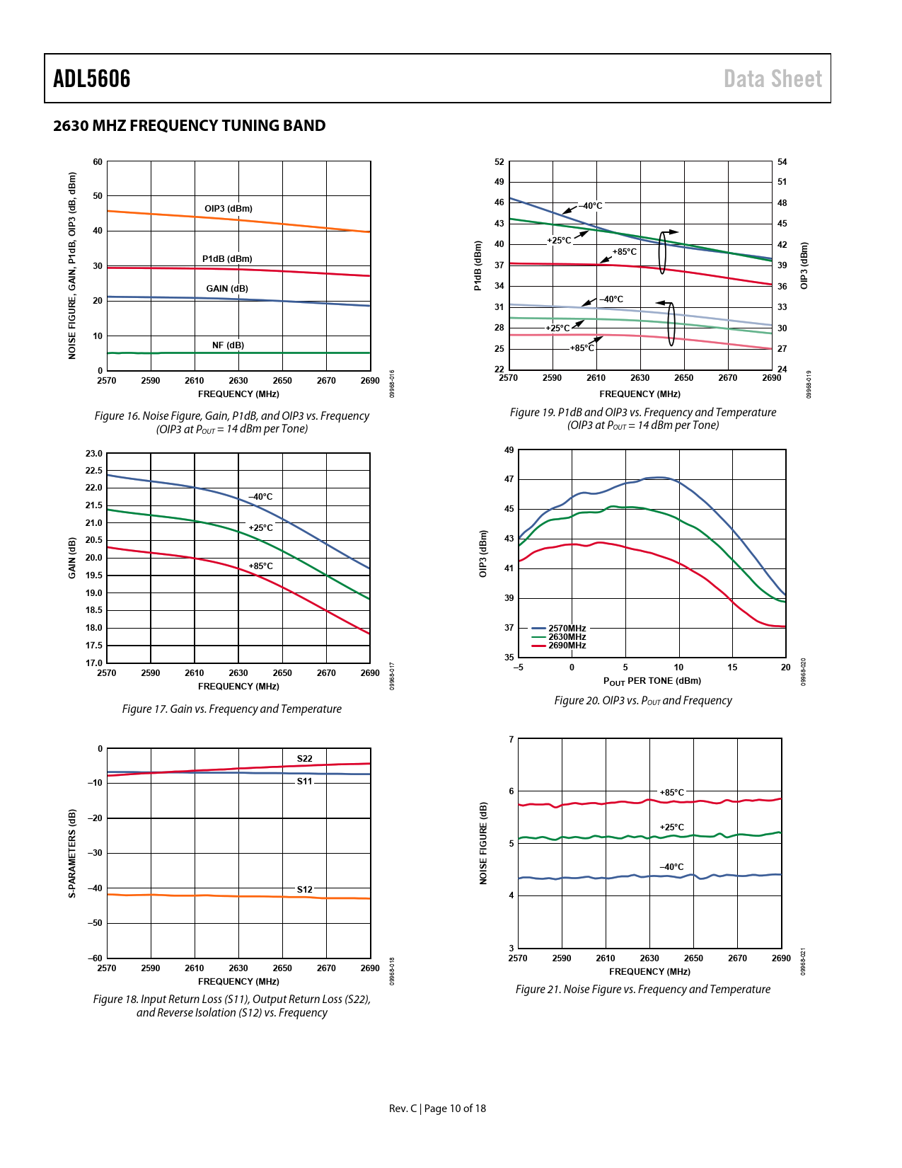

ADL5606. Data Sheet. 2630 MHZ FREQUENCY TUNING BAND. ) m. , dB. OIP3 (dBm). –40°C. 3 (d. , OIP B. +25°C. +85°C. P1dB (dBm). B d. , P. (dB. 3 (. 1dB P
ADL5606 Data Sheet 2630 MHZ FREQUENCY TUNING BAND ) m , dB OIP3 (dBm) –40°C 3 (d , OIP B +25°C +85°C P1dB (dBm) B d , P (dB 3 ( 1dB P
ADL5606 Data Sheet 2630 MHZ FREQUENCY TUNING BAND 60 52 54 ) m 49 51 , dB 50 B 46 48 OIP3 (dBm) –40°C 3 (d 43 45 40 , OIP B ) +25°C ) m 40 42 m 1d +85°C P1dB (dBm) B d , P 30 (dB 37 39 IN 3 ( 1dB P 34 36 OIP , GA GAIN (dB) E –40°C R 20 U 31 33 G FI 28 +25°C 30 E 10 IS NF (dB) O 25 +85°C 27 N 0 22 24 2570 2590 2610 2630 2650 2670 2690

0996 Figure 16. Noise Figure, Gain, P1dB, and OIP3 vs. Frequency Figure 19. P1dB and OIP3 vs. Frequency and Temperature (OIP3 at P (OIP3 at POUT = 14 dBm per Tone) OUT = 14 dBm per Tone)
23.0 49 22.5 47 22.0 –40°C 21.5 45 21.0 +25°C ) ) m B 20.5 43 (d 20.0 IN 3 (dB +85°C P 41 GA 19.5 OI 19.0 39 18.5 18.0 37 2570MHz 2630MHz 17.5 2690MHz 35 17.0 –5 0 5 10 15 20

09 09968- Figure 20. OIP3 vs. POUT and Frequency Figure 17. Gain vs. Frequency and Temperature
7 0 S22 –10 S11 6 +85°C ) B B) –20 (d (d S RE +25°C U ER IG 5 ET –30 F M A ISE –40°C R A NO –40 S12 S-P 4 –50 3 –60 2570 2690

09968- Figure 21. Noise Figure vs. Frequency and Temperature Figure 18. Input Return Loss (S11), Output Return Loss (S22), and Reverse Isolation (S12) vs. Frequency Rev. C | Page 10 of 18 Document Outline FEATURES APPLICATIONS GENERAL DESCRIPTION FUNCTIONAL BLOCK DIAGRAM TABLE OF CONTENTS REVISION HISTORY SPECIFICATIONS TYPICAL SCATTERING PARAMETERS ABSOLUTE MAXIMUM RATINGS THERMAL RESISTANCE ESD CAUTION PIN CONFIGURATION AND FUNCTION DESCRIPTIONS TYPICAL PERFORMANCE CHARACTERISTICS 1960 MHZ FREQUENCY TUNING BAND 2140 MHZ FREQUENCY TUNING BAND 2630 MHZ FREQUENCY TUNING BAND GENERAL APPLICATIONS INFORMATION BASIC LAYOUT CONNECTIONS Power Supply RF Input Interface RF Output Interface Power-Down ADL5606 MATCHING ACPR AND EVM THERMAL CONSIDERATIONS SOLDERING INFORMATION AND RECOMMENDED PCB LAND PATTERN EVALUATION BOARD OUTLINE DIMENSIONS ORDERING GUIDE
