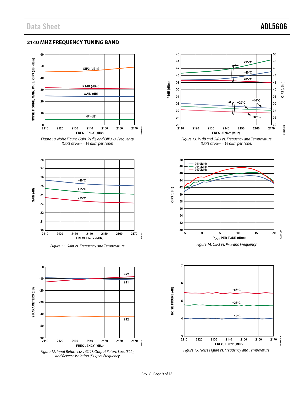

Data Sheet. ADL5606. 2140 MHZ FREQUENCY TUNING BAND. ) m. +25°C. , dB. OIP3 (dBm). 3 (. –40°C. , OIP. +85°C. P1dB (dBm). , P. GAIN (dB). 1dB. OIP
Data Sheet ADL5606 2140 MHZ FREQUENCY TUNING BAND ) m +25°C , dB OIP3 (dBm) 3 ( –40°C , OIP +85°C P1dB (dBm) , P GAIN (dB) 1dB OIP
Data Sheet ADL5606 2140 MHZ FREQUENCY TUNING BAND 60 46 50 ) m 44 48 +25°C , dB 50 B 42 46 d OIP3 (dBm) 3 ( –40°C 40 44 40 , OIP +85°C B ) ) 38 42 m m 1d P1dB (dBm) dB , P 30 dB ( 36 40 IN 3 ( GAIN (dB) 1dB 34 38 P OIP , GA E –40°C R 20 +25°C U 32 36 G FI 30 34 E 10 IS NF (dB) O 28 +85°C 32 N 0 26 30 2110 2120 2130 2140 2150 2160 2170

09968- Figure 10. Noise Figure, Gain, P1dB, and OIP3 vs. Frequency Figure 13. P1dB and OIP3 vs. Frequency and Temperature (OIP3 at POUT = 14 dBm per Tone) (OIP3 at POUT = 14 dBm per Tone)
28 50 2110MHz 48 27 2140MHz 2170MHz 46 26 –40°C 44 25 ) ) 42 +25°C m (dB 24 40 IN +85°C 3 (dB P GA OI 38 23 36 22 34 21 32 20 30

0996 Figure 11. Gain vs. Frequency and Temperature Figure 14. OIP3 vs. POUT and Frequency
0 7 S22 –10 S11 6 ) B) –20 B +85°C (d (d S RE ER U T 5 E –30 IG F +25°C ISE ARAM -P –40 NO S –40°C S12 4 –50 –60 3

09968- 09968- Figure 12. Input Return Loss (S11), Output Return Loss (S22), Figure 15. Noise Figure vs. Frequency and Temperature and Reverse Isolation (S12) vs. Frequency Rev. C | Page 9 of 18 Document Outline FEATURES APPLICATIONS GENERAL DESCRIPTION FUNCTIONAL BLOCK DIAGRAM TABLE OF CONTENTS REVISION HISTORY SPECIFICATIONS TYPICAL SCATTERING PARAMETERS ABSOLUTE MAXIMUM RATINGS THERMAL RESISTANCE ESD CAUTION PIN CONFIGURATION AND FUNCTION DESCRIPTIONS TYPICAL PERFORMANCE CHARACTERISTICS 1960 MHZ FREQUENCY TUNING BAND 2140 MHZ FREQUENCY TUNING BAND 2630 MHZ FREQUENCY TUNING BAND GENERAL APPLICATIONS INFORMATION BASIC LAYOUT CONNECTIONS Power Supply RF Input Interface RF Output Interface Power-Down ADL5606 MATCHING ACPR AND EVM THERMAL CONSIDERATIONS SOLDERING INFORMATION AND RECOMMENDED PCB LAND PATTERN EVALUATION BOARD OUTLINE DIMENSIONS ORDERING GUIDE
