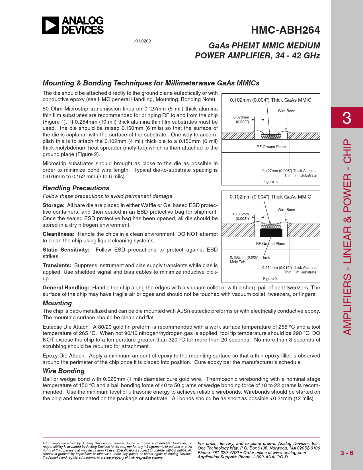

GaAs PHEMT MMIC MEDIUM POWER AMPLIFIER, 34 - 42 GHz Mounting & Bonding Techniques for Millimeterwave GaAs MMICs
The die should be attached directly to the ground plane eutectical y or with conductive epoxy (see hmC general handling, mounting, Bonding note). 0.102mm (0.004”) Thick GaAs MMIC 50 ohm microstrip transmission lines on 0.127mm (5 mil) thick alumina Wire Bond thin film substrates are recommended for bringing rf to and from the chip 0.076mm (figure 1). if 0.254mm (10 mil) thick alumina thin film substrates must be (0.003”) 3 used, the die should be raised 0.150mm (6 mils) so that the surface of the die is coplanar with the surface of the substrate. one way to accom- plish this is to attach the 0.102mm (4 mil) thick die to a 0.150mm (6 mil) thick molybdenum heat spreader (moly-tab) which is then attached to the RF Ground Plane ip ground plane (figure 2). h microstrip substrates should brought as close to the die as possible in order to minimize bond wire length. Typical die-to-substrate spacing is 0.127mm (0.005”) Thick Alumina 0.076mm to 0.152 mm (3 to 6 mils). Thin Film Substrate Figure 1. r - C

Mounting
The chip is back-metal ized and can be die mounted with Ausn eutectic preforms or with electrical y conductive epoxy. lif The mounting surface should be clean and flat. p eutectic Die Attach: A 80/20 gold tin preform is recommended with a work surface temperature of 255 °C and a tool m temperature of 265 °C. when hot 90/10 nitrogen/hydrogen gas is applied, tool tip temperature should be 290 °C. Do A noT expose the chip to a temperature greater than 320 °C for more than 20 seconds. no more than 3 seconds of scrubbing should be required for attachment. epoxy Die Attach: Apply a minimum amount of epoxy to the mounting surface so that a thin epoxy fil et is observed around the perimeter of the chip once it is placed into position. Cure epoxy per the manufacturer’s schedule.
Wire Bonding
Ball or wedge bond with 0.025mm (1 mil) diameter pure gold wire. Thermosonic wirebonding with a nominal stage temperature of 150 °C and a ball bonding force of 40 to 50 grams or wedge bonding force of 18 to 22 grams is recom- mended. Use the minimum level of ultrasonic energy to achieve reliable wirebonds. wirebonds should be started on the chip and terminated on the package or substrate. All bonds should be as short as possible <0.31mm (12 mils). Info F rmoatri op n rfiurcne is ,h ed d ebly ivAe n r al y o g aDn evdic eto s i p s bla eli c evee d otro dbe e ras: cc uH ratite tiatne d M reli iac bl reo . w Ho av wev e er , Cno o For price, delivery, and to place orders: Analog Devices, Inc., responsibility is assumed by Analog Devices for its use, nor for any infringements of patents or other rporation, 20 Alpha Road, Chelmsford, MA 01824 One Technology Way, P.O. Box 9106, Norwood, MA 02062-9106 Phone: 978-250-3343 Fax: 978-250-3373 rights of third parties that may result from its use. Specifications subject to change without notice. No O P r h d o e ne r O : 7 n 81- -3li 2n 9 e - 4 a 7 t 0 ww 0 • O w rd .h e it r o tniltie n .c e ao t m license is granted by implication or otherwise under any patent or patent rights of Analog Devices. www.analog.com
