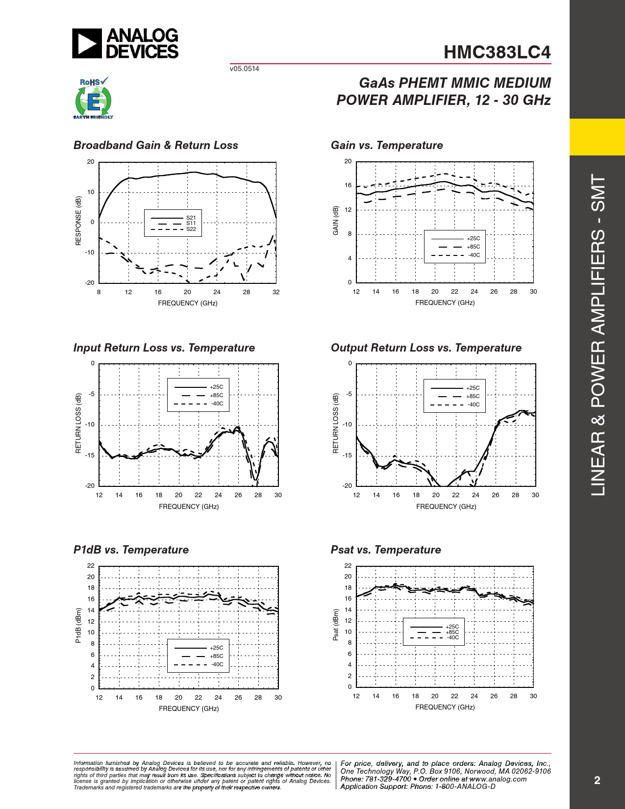

HMC383LC4. GaAs PHEMT MMIC MEDIUM. POWER AMPLIFIER, 12 - 30 GHz. Broadband Gain & Return Loss. Gain vs. Temperature
HMC383LC4 GaAs PHEMT MMIC MEDIUM POWER AMPLIFIER, 12 - 30 GHz Broadband Gain & Return Loss Gain vs Temperature
HMC383LC4
v05.0514
GaAs PHEMT MMIC MEDIUM POWER AMPLIFIER, 12 - 30 GHz Broadband Gain & Return Loss Gain vs. Temperature
20 20 16 T 10 M (dB) 12 S21 (dB) 0 S11 S22 GAIN 8 +25C S - S RESPONSE +85C -10 -40C R 4 IE -20 0 8 12 16 20 24 28 32 12 14 16 18 20 22 24 26 28 30 LIF FREQUENCY (GHz) FREQUENCY (GHz) P M
Input Return Loss vs. Temperature Output Return Loss vs. Temperature
R A 0 0 E W +25C +25C -5 +85C -5 +85C O -40C -40C -10 -10 R & P RETURN LOSS (dB) RETURN LOSS (dB) -15 -15 A E -20 -20 12 14 16 18 20 22 24 26 28 30 12 14 16 18 20 22 24 26 28 30 LIN FREQUENCY (GHz) FREQUENCY (GHz)
P1dB vs. Temperature Psat vs. Temperature
22 22 20 20 18 18 16 16 14 14 12 12 (dBm) +25C 10 10 +85C -40C Psat P1dB (dBm) 8 8 +25C 6 6 +85C 4 -40C 4 2 2 0 0 12 14 16 18 20 22 24 26 28 30 12 14 16 18 20 22 24 26 28 30 FREQUENCY (GHz) FREQUENCY (GHz) Inf F or o m r p atio r n ifc ur e n , d ishe e d lbiv y e A r n y a alog n D d t evic o p es is la beclie o eved rd to ebre sa: H ccur iattti e tae M nd re ilicarbloew . H a o ve C wever, o n rp o For price, delivery, and to place orders: Analog Devices, Inc., responsibility is assumed by Analog Devices for its use, nor for any infringements of patents or other oration, 2 Elizabeth Drive, Chelmsford, MA 01824 One Technology Way, P.O. Box 9106, Norwood, MA 02062-9106 Phone: 978-250-3343 Fax: 978-250-3373 O rights of third parties that may result from its use. Specifications subject to change without notice. No P rd hone e r O : 7 n 81- -3li 2n 9 e a -47 t w 0 w 0 • O w rd .h e it r o t niltie n .c e ao t m license is granted by implication or otherwise under any patent or patent rights of Analog Devices. www.analog.com
