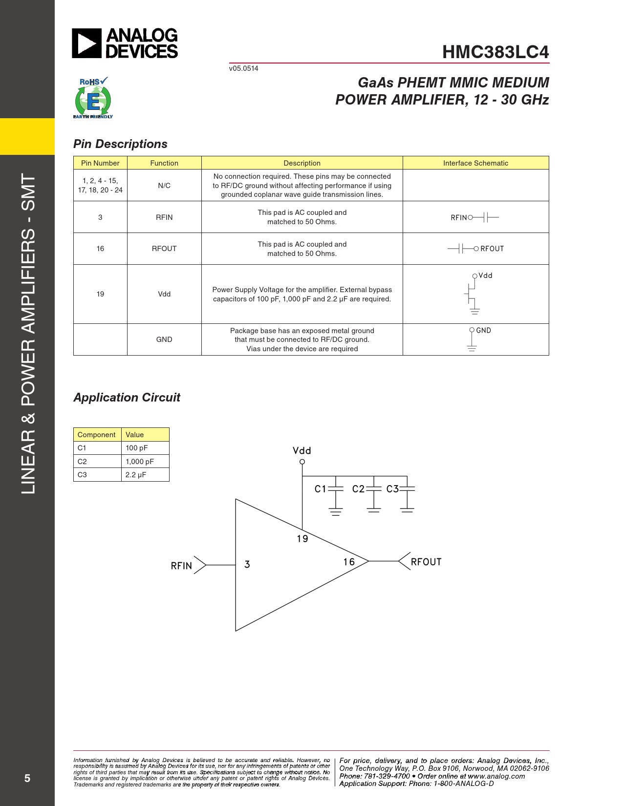

HMC383LC4. GaAs PHEMT MMIC MEDIUM. POWER AMPLIFIER, 12 - 30 GHz. Pin Descriptions. Application Circuit
HMC383LC4 GaAs PHEMT MMIC MEDIUM POWER AMPLIFIER, 12 - 30 GHz Pin Descriptions Application Circuit
HMC383LC4
v05.0514
Pin Number Function Description Interface Schematic T No connection required. These pins may be connected 1, 2, 4 - 15, M N/C to RF/DC ground without affecting performance if using 17, 18, 20 - 24 grounded coplanar wave guide transmission lines. This pad is AC coupled and 3 RFIN matched to 50 Ohms. S - S R This pad is AC coupled and 16 RFOUT IE matched to 50 Ohms. LIF Power Supply Voltage for the amplifier. External bypass P 19 Vdd capacitors of 100 pF, 1,000 pF and 2.2 µF are required. M Package base has an exposed metal ground R A GND that must be connected to RF/DC ground. E Vias under the device are required W O
Application Circuit
R & P Component Value A C1 100 pF E C2 1,000 pF C3 2.2 µF LIN Inf F or o m r p atio r n ifc ur e n , d ishe e d lbiv y e A r n y a alog n D d t evic o p es is la beclie o eved rd to ebre sa: H ccur iattti e tae M nd re ilicarbloew . H a o ve C wever, o n rp o For price, delivery, and to place orders: Analog Devices, Inc., responsibility is assumed by Analog Devices for its use, nor for any infringements of patents or other oration, 2 Elizabeth Drive, Chelmsford, MA 01824 One Technology Way, P.O. Box 9106, Norwood, MA 02062-9106 Phone: 978-250-3343 Fax: 978-250-3373 O rights of third parties that may result from its use. Specifications subject to change without notice. No P rd hone e r O : 7 n 81- -3li 2n 9 e a -47 t w 0 w 0 • O w rd .h e it r o t niltie n .c e ao t m
