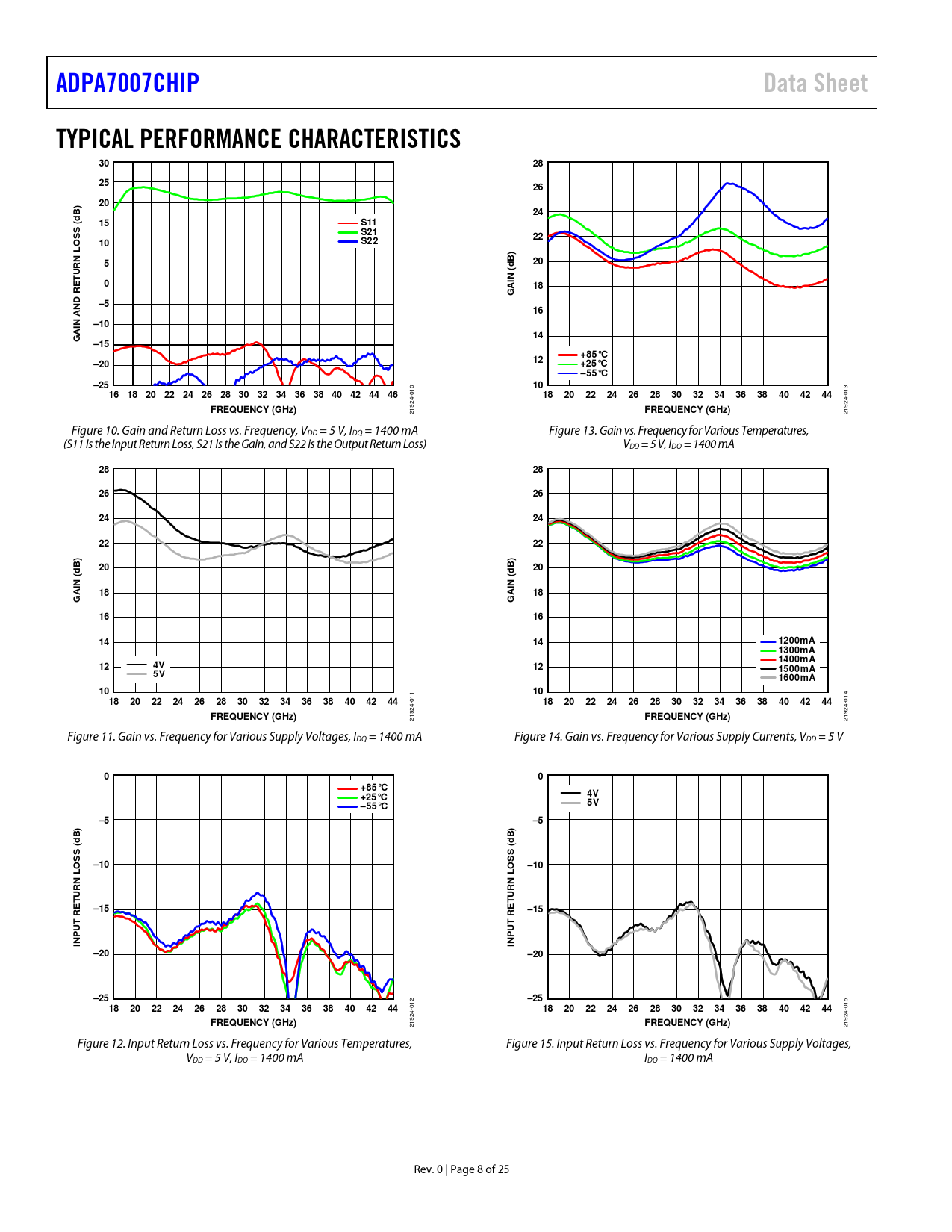

ADPA7007CHIP. Data Sheet. TYPICAL PERFORMANCE CHARACTERISTICS. d (. S11. S S. S21. S22. URN L T. N (. N AND RE. –10. AI G. –15. +85°C. –20. +25°C –55°C
ADPA7007CHIP Data Sheet TYPICAL PERFORMANCE CHARACTERISTICS d ( S11 S S S21 S22 URN L T N ( N AND RE –10 AI G –15 +85°C –20 +25°C –55°C
ADPA7007CHIP Data Sheet TYPICAL PERFORMANCE CHARACTERISTICS 30 28 25 26 20 B) 24 d ( 15 S11 S S S21 22 O 10 S22 B) 5 d 20 URN L T N ( 0 AI 18 G –5 16 N AND RE –10 AI G 14 –15 +85°C 12 –20 +25°C –55°C –25 10 16 18 20 22 24 26 28 30 32 34 36 38 40 42 44 46
010
013
FREQUENCY (GHz)
21924-
FREQUENCY (GHz)
21924- Figure 10. Gain and Return Loss vs. Frequency, VDD = 5 V, IDQ = 1400 mA Figure 13. Gain vs. Frequency for Various Temperatures, (S11 Is the Input Return Loss, S21 Is the Gain, and S22 is the Output Return Loss) VDD = 5 V, IDQ = 1400 mA
28 28 26 26 24 24 22 22 B) B) d 20 d 20 N ( N ( AI 18 AI 18 G G 16 16 14 14 1200mA 1300mA 1400mA 12 4V 12 1500mA 5V 1600mA 10
014
FREQUENCY (GHz)
21924-
FREQUENCY (GHz)
21924- Figure 11. Gain vs. Frequency for Various Supply Voltages, IDQ = 1400 mA Figure 14. Gain vs. Frequency for Various Supply Currents, VDD = 5 V
0 0 +85°C +25°C 4V –55°C 5V –5 –5 B) B) d d ( ( S S S S O –10 O –10 URN L URN L T T –15 –15 RE RE UT UT INP INP –20 –20 –25 –25 18 20 22 24 26 28 30 32 34 36 38 40 42 44

FREQUENCY (GHz)
21924-
FREQUENCY (GHz)
21924- Figure 12. Input Return Loss vs. Frequency for Various Temperatures, Figure 15. Input Return Loss vs. Frequency for Various Supply Voltages, VDD = 5 V, IDQ = 1400 mA IDQ = 1400 mA Rev. 0 | Page 8 of 25 Document Outline FEATURES APPLICATIONS FUNCTIONAL BLOCK DIAGRAM GENERAL DESCRIPTION TABLE OF CONTENTS REVISION HISTORY SPECIFICATIONS 18 GHz TO 22 GHz FREQUENCY RANGE 22 GHz TO 36 GHz FREQUENCY RANGE 36 GHz TO 44 GHz FREQUENCY RANGE ABSOLUTE MAXIMUM RATINGS THERMAL RESISTANCE ELECTROSTATIC DISCHARGE (ESD) RATINGS ESD Ratings ADPA7007CHIP ESD CAUTION PIN CONFIGURATION AND FUNCTION DESCRIPTIONS INTERFACE SCHEMATICS TYPICAL PERFORMANCE CHARACTERISTICS CONSTANT IDD OPERATION THEORY OF OPERATION APPLICATIONS INFORMATION MOUNTING AND BONDING TECHNIQUES FOR MILLIMETERWAVE GAAS MMICS Handling Precautions Mounting Wire Bonding BIASING ADPA7007CHIP WITH THE HMC980LP4E APPLICATION CIRCUIT SETUP LIMITING VGATE FOR ADPA7007CHIP VGGx ABSOLUTE MAXIMUM RATING REQUIREMENT HMC980LP4E BIAS SEQUENCE Power-Up Sequence Power-Down Sequence CONSTANT DRAIN CURRENT BIASING vs. CONSTANT GATE VOLTAGE BIASING TYPICAL APPLICATION CIRCUIT ASSEMBLY DIAGRAM OUTLINE DIMENSIONS ORDERING GUIDE
